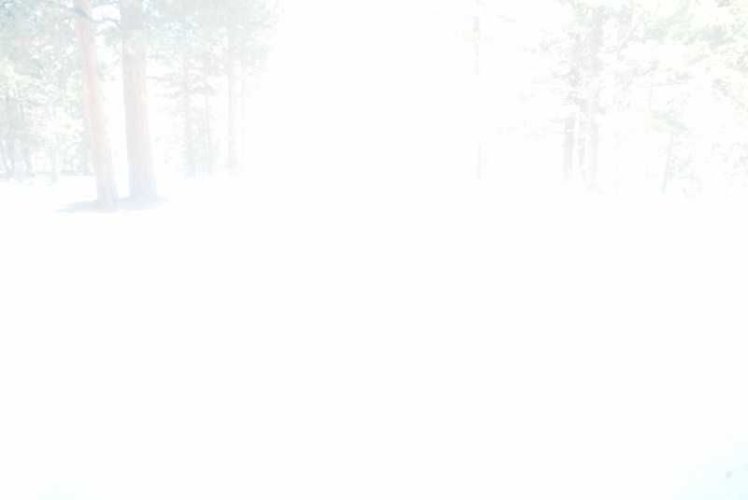

Night pics. All shots were taken at the same exposure to attempt to show the difference. The light is brighter in person if you can believe it.
Shutter speed: 1/13
Exposure Program: Manual
F-sto: f/3.5
ISO speed: 1600
Focal Legnth: 18mm
Flash: Did not fire
This is with a 35watt HID in the low beams:
This is a 55watt HID in the high beams (stupid bright by itself):
50" E series
Beater
Dec 7, 2005
2,786
denver
wow. really. looks like your lows/highs are reversed in aim though, or do you have that on purpose. I know I did that on the rover, well kinda, I special ordered h4 bulbs that were higher wattage/lumens on low beam.
