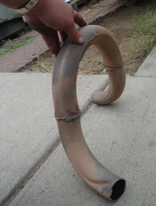

from there, it was on to operation scary exhaust. while i'm a bit nervous about my skills welding a seam sealed and in a hard to get to spot, i decided i just had to get it over with, so out came the sawzall and the scary chunk of exhaust.
for now, i'll weld in a less restrictive 2 1/4 chunk of straight to a small piece of flex in place of whatever the f...this was.

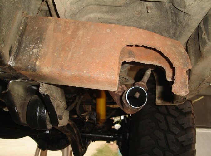

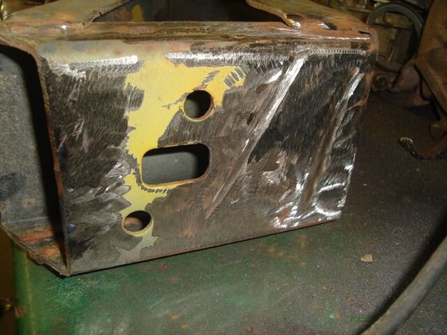

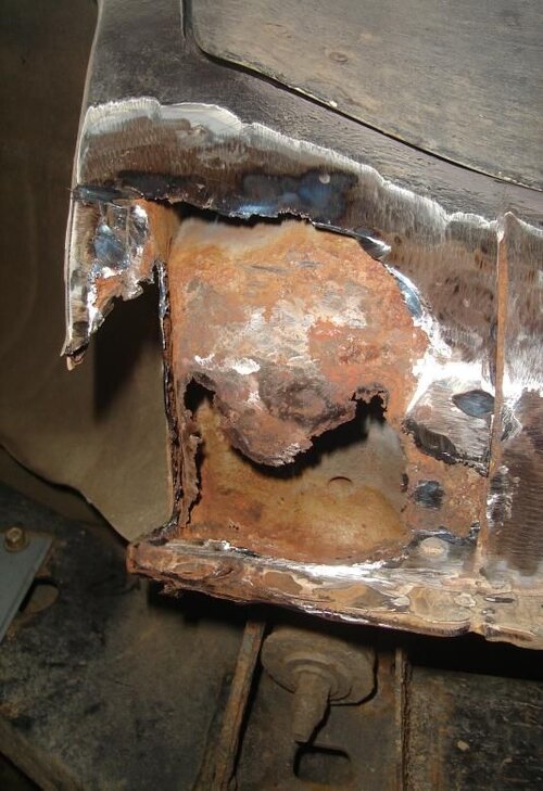

this was all on the same side as the slider that was welded at the wrong angle, had too big of a kickout hoop, and fell off, so i figured now was a good time to get the "mount" for the slider cut off. still need to grind what's left down.

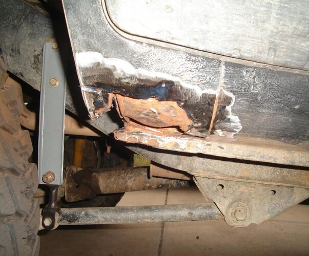

also figured i'd take a look at the one rust spot that was on the body since it seemed like it has grown exponentially in the last few months. it has.

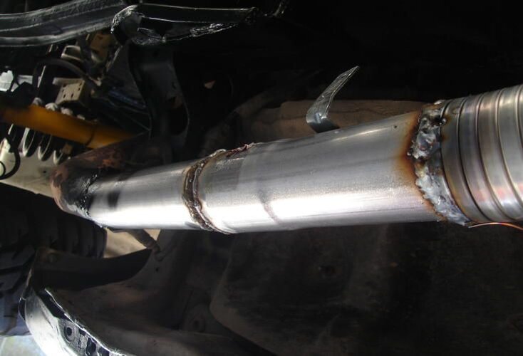

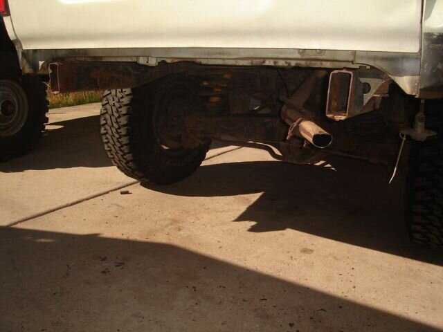

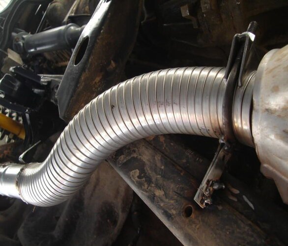

temp exhaust ain't pretty, but it is done. much straighter path and 1/4" larger diameter so that hopefully will help the engine breath. and it still doesn't hang down any more than the p.o.s elbows on the old exhaust, there's just more there. i'm not too concerned since i won't be gettting much wheeling in for a while and it is a temporary setup. new exhaust from the headers back is pretty high on my list.
did find out that of all my local auto parts stores, advance has the best choices for exhaust (and even theirs sucks), no one carries just straight exhaust tubing (it all has the flare at the end, which just means more stuff to play with the welder on ;)), flex pipe only comes with one saddle clamp, and contrary to the proper way to install flex, you can weld it on when you realize you can't find any of the saddle clamps that you know you have somewhere :D
used a flattened corner bracket to make a support to the frame, also not pretty, but now my exhaust doesn't shake like it use to either.

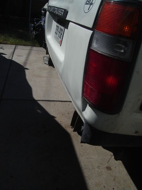

operation extenze has begun

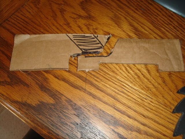

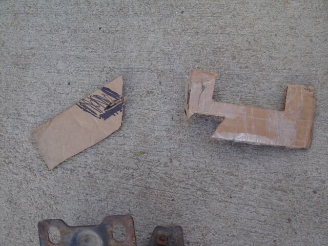

i've made the templates and am nervously preparing for the first cut. the plan is to add on the rear frame section that was cut off by the po.

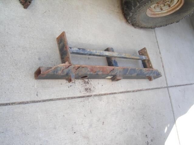

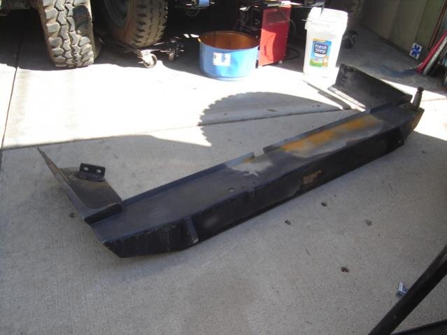

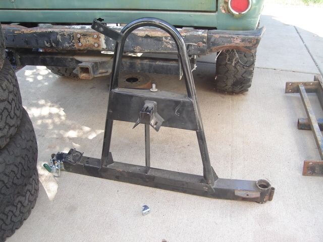

you can see the nasty ole bumper the po put on.
my plan is to install the sweet azz bumper/tire carrier from nathaniel. :thumb:

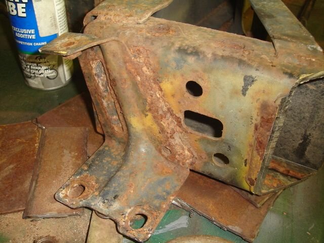

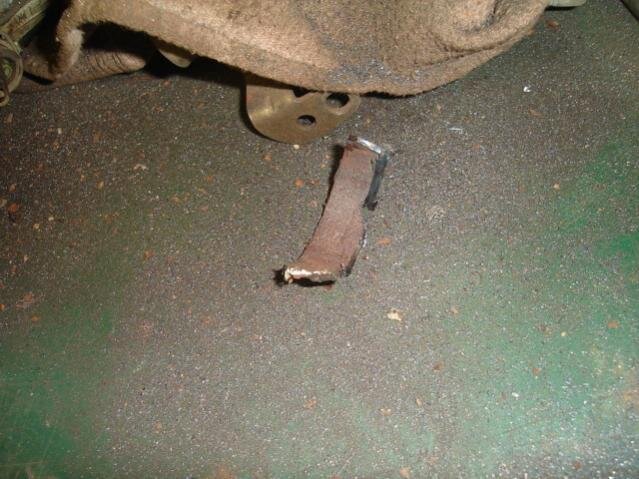

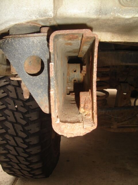

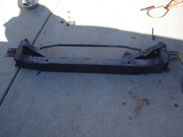

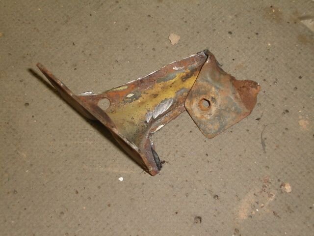

holy crap this is gonna take a while:eek: 45 minutes just to get this one bracket off...positive side, i'm halfway there:rolleyes:

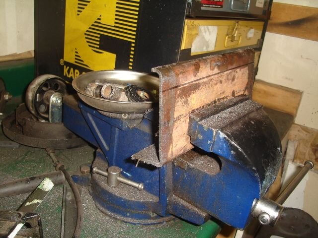

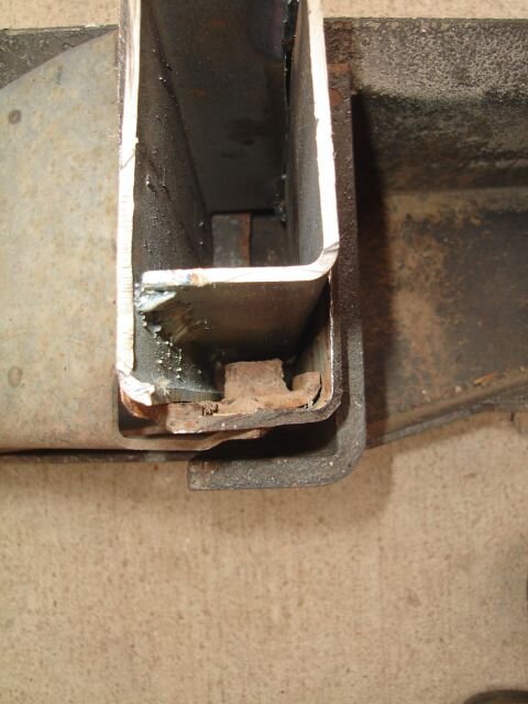

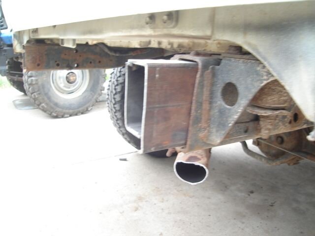

got the sleeves made...modified rectangular stock. made the pattern for the top/bottom of the frame. spent all day and will spend some of tomorrow in welding foreplay before i get it all on.
did find one little issue...i was testing the fit of the sleeves on the new frame section...not the old one. found this little nut that the po welded in (only on one side, the other side the weld didnt' hold and the nut was gone. :rolleyes:). also, if you look close, you'll see the inside edge of the frame is bent in a bit...i'll have to do some tweaking.:(
