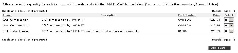

OK, UB, all... what check valve do I really need? I have two compressors that seem to work fine, but no check valves. The one above, Jeff, is pretty big (and $$$), I liked the cheapie Nakman posted, but is that the right one?

Here is the unloaderthat I have used in the past from one of the links Jeff posted. As far as dust cap disconnects I believe you want an "M" style. That is the most common.

Post up a link please. I've been to HF, HD, Lowes, Sears, and TZ and they don't have rubber things, and yeah I asked. In fact they don't have check valves either... only filter toolzone had was a dessicant one that's probably the wrong one but I bought it anyway, I will swap it out if it doesn't work out.
But I had forgotten that I managed to order a check valve from the same place I ordered the pressure switch (one o dem OBA jeep places) so I'm good there, except now I want two :rolleyes:
I got my last filter/dryer from Lowes. It's just the small cheapie but seems to work well. On Wildrice I have an oiler on the inflow full of Slick 50 and it gets pulled back out in the dryer (I use a Toy AC compressor....wery high volumn, fits easily but isn't self lubricated.)
15,508
Thanks Jeff! and c'mon, Bill, $22? :p: Want to split shipping on these? If we order today I bet we could hook up next Wednesday. Anyone else? Dan? I'll probably get the last one since it's cheapest, looks like I'm buying more fittings no matter what..

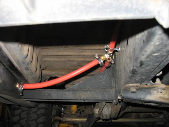

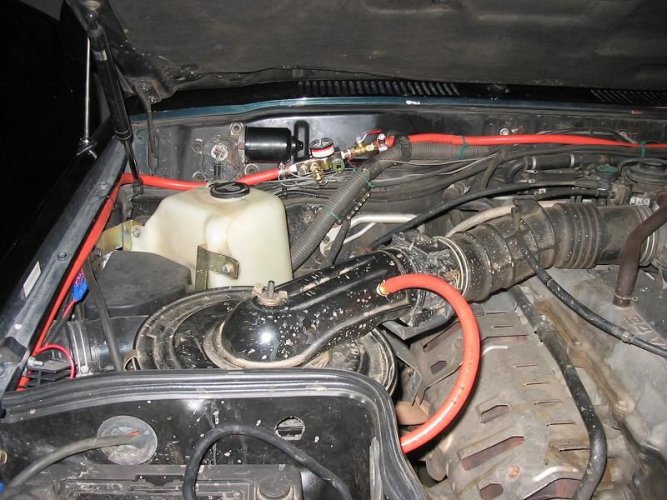

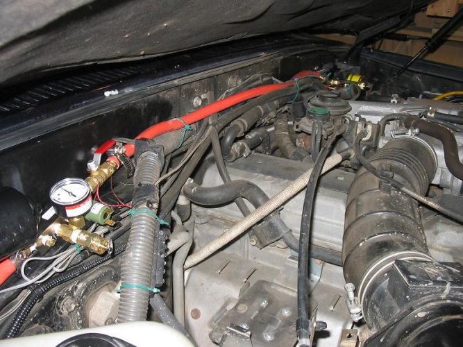

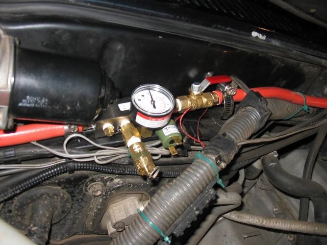

install pics...
Ok, made some headway last night with the install. My tank came in, and I'll be putting that above the spare crossmember in back, most likely Thursday night or this weekend.. that only leaves the compressor itself, and the filter to install. I think I have to put the filter close to the compressor, behind the 2nd battery, there's just no other place to put it where it won't get smashed by the hood... things are getting kind of crouded in here :blah:
