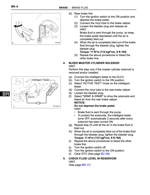

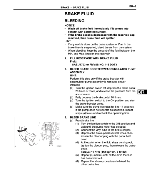

Yessir, a 4th gen (2003-2009) would have the electronic master with ABS and traction and stability control. They are a bit more of a pain to work on because the bleeding procedure is more involved. You have to do the pedal pumping or holding and key on and off sequences right.
This is from the 2007 FSM.

We're learning over here. Brake fluid should not be dark brown muddy almost black. And I can't remember if not being like that since like 2014? I assumed it was supposed to be dark and there was plenty of fluid in it so I thought all was well and good.
We're going to try a flush and see what happens.
I don't know how any other mechanic didn't say anything about this. I'm starting to think they never looked.

After the brake flush things were a lot better. The buzzing of the pump thing is still going off but I think that can wait until I get home.
