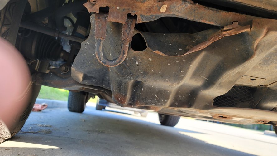

I think I went over a giant rock. I'm not really sure what happened tbh. Shop 2 said my skid plate was so mangled I'd need a new one. They said it pushed up into the bay and caused damage to the radiator and other parts so I'd need a new radiator among other things. At a few thousand.
Shop 3 with more relevant experience said there is damage to the skid plate but parts inside seems to be undamaged and they should be okay. They welded back the torn backwards tow point and said they getting a new skid would not fix it because I've got frame damage that basically matches the skid plate so without doing frame repair that would be very costly I'm better off just keeping my skid plate as is.

I would say the biggest issue that you need addressed is the brakes. That's going to be a hard one to figure out right now online. Someone local to The Springs might be able to help, but we don't have a ton of people on this forum that live down that way. Maybe one of them can chime in.

Not the best pictures but this is one view. Kind of hard to get a full picture.
I have enough clearance to shimmy under it at stock height (9.1"?) And have my face to the skid as I have ratchet and extender to get off the oil bolt off without raising it up.
This was before it got fixed.
