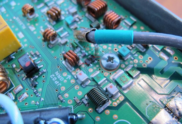

Harder to find D3023 and D3039.

I haven't had chance to open it up yet. I emailed the guy from the yahoo group back and got this. By the way it seems like you two are on the same page.
"Look on page 55 Service Manual bottom Right Hand corner. If you follow circuit trace from Q3024 (2SC3102) collector lead towards the right, notice the trace leads to input of LPF----VU TX RF trace. Follow to R3069 33ohm 1 watt resistor which leads off to right from VU TX RF trace. Throght L3031
to D3019 and D3022 which lead off right to end of Schematic These are the two PIN diodes I mentioned , D3019 is the one I found bad in the rig I worked on. It is SMD components and not for the faint hearted soldering tech.
Should be 5vdc on tX at anode and about 0.2 to 0.5vdc drop at cathode or just do the usual check from circuit trace solder pad to anode, circuit trace solder pad to cathode, then anode to cathode, and the reverse ie; cathode to anode for ohmic checks. NOTE*****SMD capacitors at each end woould block DC continuity, but couples RF through, therefore in circuit checks okay.
Most DVMs have a diode check function selection or just measure the resistance thru. Should be close to infinite reverse biased. Will be low ohms resistance forward.
Also note from my previous email to you. The section that I'm pointing out is the UHF transmit path. If, the diodes not bad-----something in that section indicated most likely your problem as that is confined to 440Mhz. There is a separate section above it for two meters or VHF. At the end of that chain trace is the sensor for your SWR/FWD metering-----any variance in SWR readings would have to be outboard of that sensor-----hint hint.
