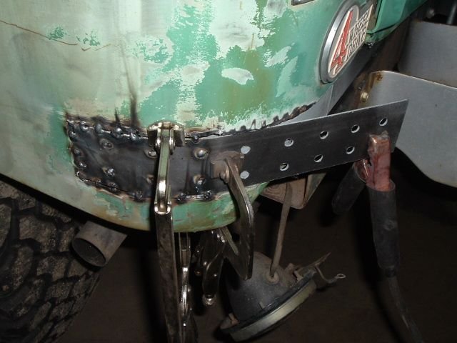

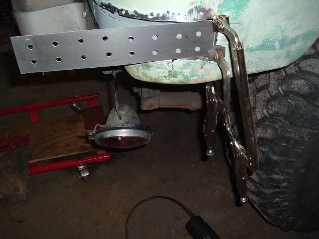

Clamp it up and get ready to weld!
8,878

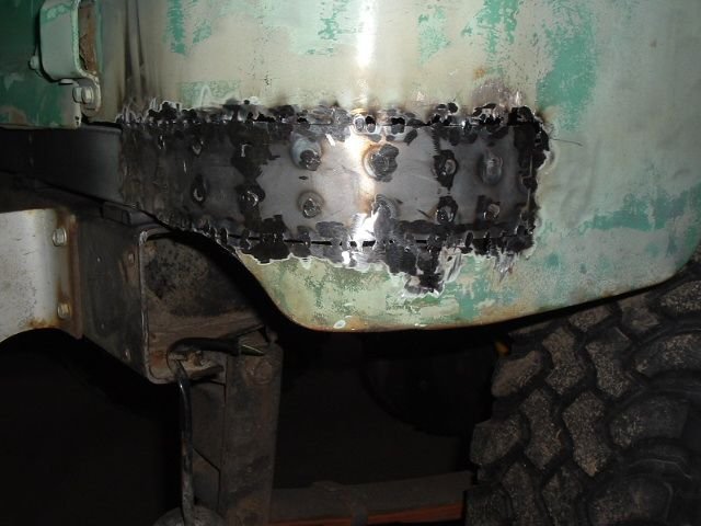

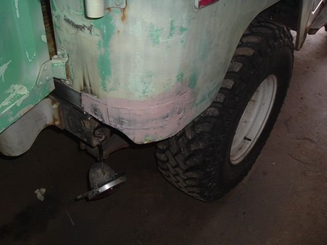

One side all welded up, with the welds ground down. I did blow through some where the old metal was thin, it's tough to get the right setting for different thicknesses. Nothing a little body filler won't fix. It's still solid. Obviously, if I had more time I would have done the whole QP, but this is just a quickie job to get ready for Moab.

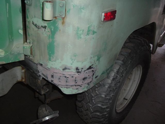

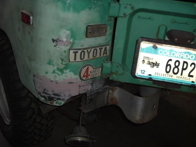

8,878

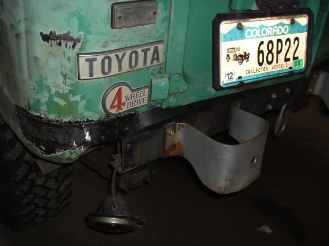

Body filler, sand, body filler, sand, repeat.

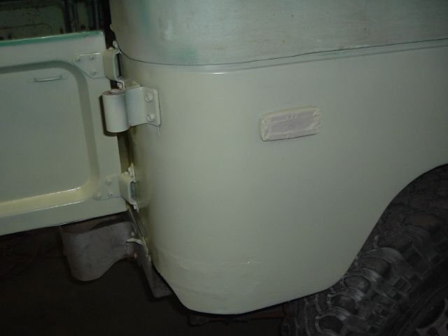

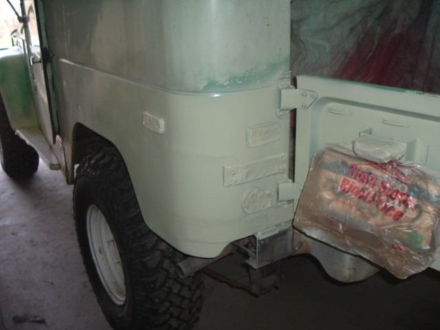

8,878
Some Krylon "Celery" colored rattle can and it's looking good. It's not nearly Oleg quality, but it's plenty solid!

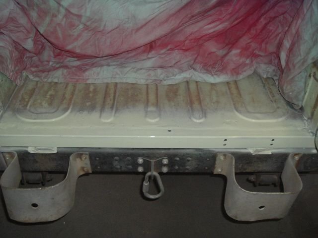

8,878
The last step was mounting the spare carrier. It was kind of a PITA, and the spare latch retainer ended up a couple millimeters too high, but I got it figured out.
