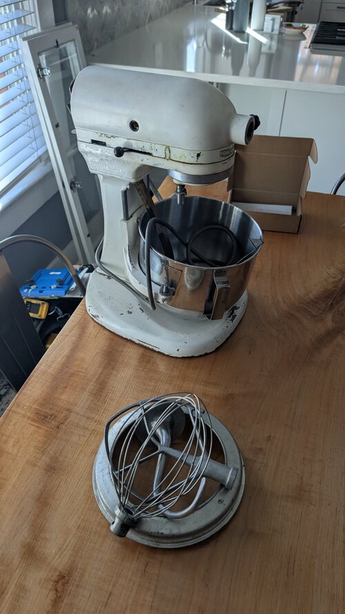

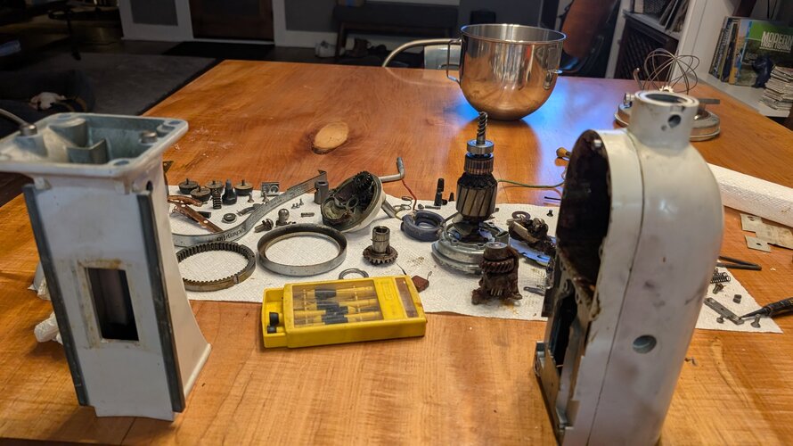

I thought the overlap between vintage KitchenAids and Toyota people might make this worth a post. I snagged a broken KitchenAid K5-A off Facebook this weekend with the plan to restore it. This model is one of the older ones and is around the early 60s.
After tearing into it I found the sacrificial worm gear was stripped and was planning on just replacing it, but after a few YouTube rabbit holes I determined upgrading the electronics to the Solid State internals, the next version of this thing in the 70s would be fun. Waiting on a bunch of parts, anyone have a suggestion for sand blasting and powder coating for small projects? I can't remember place I used for the 40, just that it was down south.
