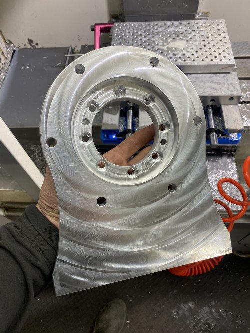

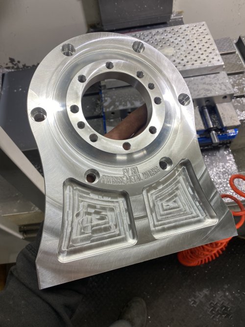

Jimmy and I chatted at Cruise Moab and I knew immediately I could help him out with the motor/transfer case coupler. Little did I know it would be this challenging….
First piece is the Black Box to “torque tube” adapter. The adapter needs to be 14” long, so we are coupling the two components with a thick wall tube with bearing support for the coupler shaft. Bottom of this plate will have vibration isolator “motor mounts” that will bolt into the stock cross member.
