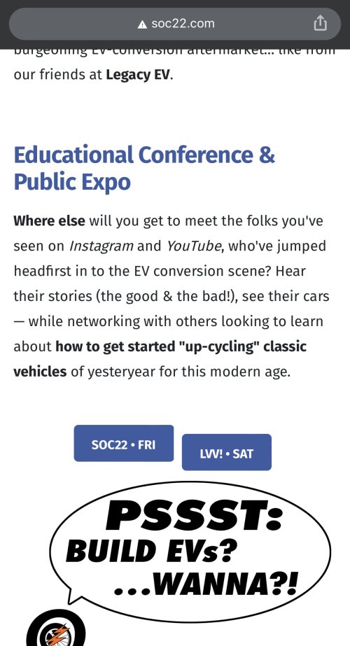

Hey Jimmy I checked that website and it says that registration is full... also that registration costs money. Is that different from just looking at the Expo? I didn't realize you guys were speaking on Friday also, that would be cool to see.
MonPetiteShoe
RS Club Commander
Oct 7, 2020
693
Aurora
Registration for the Friday conference is closed/full.
The expo on Saturday that Jimmy mentioned is open to the public and is free.
Yeah Friday is a tech discussion session with a bunch of EV conversion guys each presenting but yes it's full.
Saturday is free and open to the public! Sorry for the confusion!
