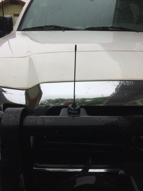

OTOH for comparison this is a full height 1/4λ whip tuned for amateur 70cm, which ends up being about 6.5" tall. For GMRS it would be barely shorter, like a couple of mm.
The equivalent CB antenna would be 9 feet (108 inches, e.g. those monster whips you used to see) tall.
For anyone interested in the actual radio stuff, this antenna will show 2.15 dBi (0 dBd) of gain, so could be fed with 5 watts with respect to the GMRS channels 1 to 7 ERP rules. However it doesn't actually perform well due to the lack of decent ground plane. When you measure will likely show high SWR that indicates you should keep cutting it shorter.
That SWR is likely a red herring because the bumper isn't a good plane unless you've grounded the mount well to the bumper (exposed bare steel under it) and bonded it to the frame to keep the body itself from coupling indirectly across rusty bolted connections. Doing that at least prevents the coax shield starting to act like the ground, which is what will happen if the mount isn't grounded well. So while eventually you could keep cutting until you get a reasonably low SWR that is actually indicating you're approaching a nonresistive dummy load rather than efficient antenna.
In that case range will probably be impacted. But since the comparison is CB that can't make 1/2 mile using a dummy load (literally a big resistor) fed with 15 or 50 watts will radiate well enough to be heard a couple of city blocks away by a sensitive radio seems pretty good. In actuality 5 watts into a decent antenna should work more or less to the horizon (line of sight limited, not signal strength). Even 1 watt should work tens of miles to highly placed repeaters with good efficiency and line of sight. A poorly grounded antenna, be it 1/4λ like this or any other, will fall somewhere in the middle. Not as good as can be but not totally a dummy load.
If you do take the time to ground the mount to the bumper it could be a decent antenna electrically but highly directional. It'll produce two strong lobes side-to-side along the upper tube, might produce a weak lobe back over the hood (that will be substantially blocked or absorbed by the cab and meatbags inside in my case) and almost no energy radiates forward. You'd notice having trouble contacting and hearing stations maybe a mile ahead of you but still randomly hear a station tens of miles away that comes and goes as you drive around switchbacks.
The shortest No-Ground Plane antennas that solve this lack of sheet metal and nonuniformity are typically a few inches taller because they elevate the feedpoint such that it's in effect a dipole turned vertical or they put an artificial ground, a coil or capacitor-inductor circuit, in the base. Those will at least work more uniformly around all 360° of the whip although the external interference (the previously mentioned meatbags) will remain. That is dealt with by elevating the antenna to the highest practical.
They may also simply use an antenna that's 1/2λ long, which would be about 35 cm or ~14 inches tall and be inherently ground plane agnostic. It may also start to show a little gain (e.g. if you're worried about respecting ERP rules). Anything taller than 14" is actually multiple elements and will almost definitely have increasing gain. Such an antenna can be made shorter by putting a loading coil in the middle so it's electrically long enough but not physically.
