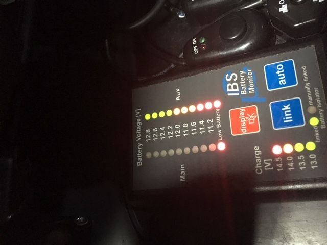

I had my ibs controller disconnected yesterday for a couple hours, while I fiddled with some other devices it needed to be removed to access. But now that I plugged it back in, it's confused thinking the main battery is dead. The main bettery is most certainly not dead nor was it even disconnected yesterday. I have tried unplugging it and plugging it in, but to no avail- it still says the main battery is dead. Any thoughts?
I'm guessing that one of two things happened:
1--the controller is pooched. You might have given it a voltage spike that killed it perhaps when plugging or unplugging it?
2--you've got a bad connection in the plug. The battery sense wires run straight to the controller typically, so unless you ran it else wise it's only real potential to get a corroded or bad connector is at the plug itself.
Dan
10,464
Centennial, Colorado
Dan
I had #2 above happen to me. Swapped out the main battery and controller said it was dead. I forgot to reconnnect the sense line from the battery to the unit

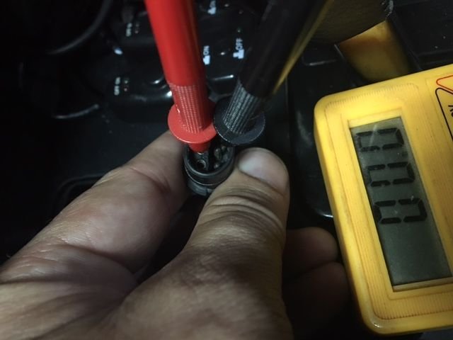

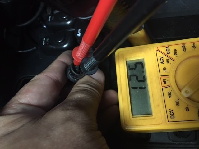

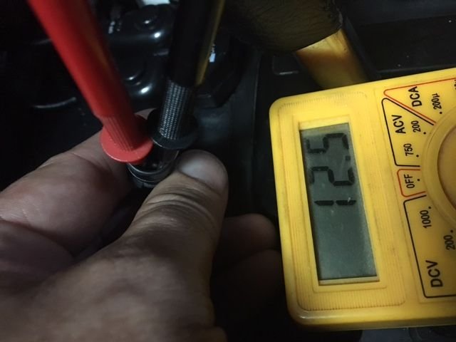

That is a good suggestion. So it looks like the "red" wire is definitely the one that is disconnected, and I'm just going to guess that's the + going to battery #1. I can measure 12.5 using either of the top two "female" terminals in the harness, and the black "male" terminal. But I can't get anything using the red "male" terminal.
And since both are 12.5, I know I'm measuring battery #2, regardless of which ground I pick. But how did I bump that red wire... I swear I wasn't anywhere near that battery :confused:

The red wire goes all the way to the battery terminal. When I disconnected the old battery the red wire slipped down where I couldnt see it and I forgot to hook it up when I installed the new battery at the terminal
