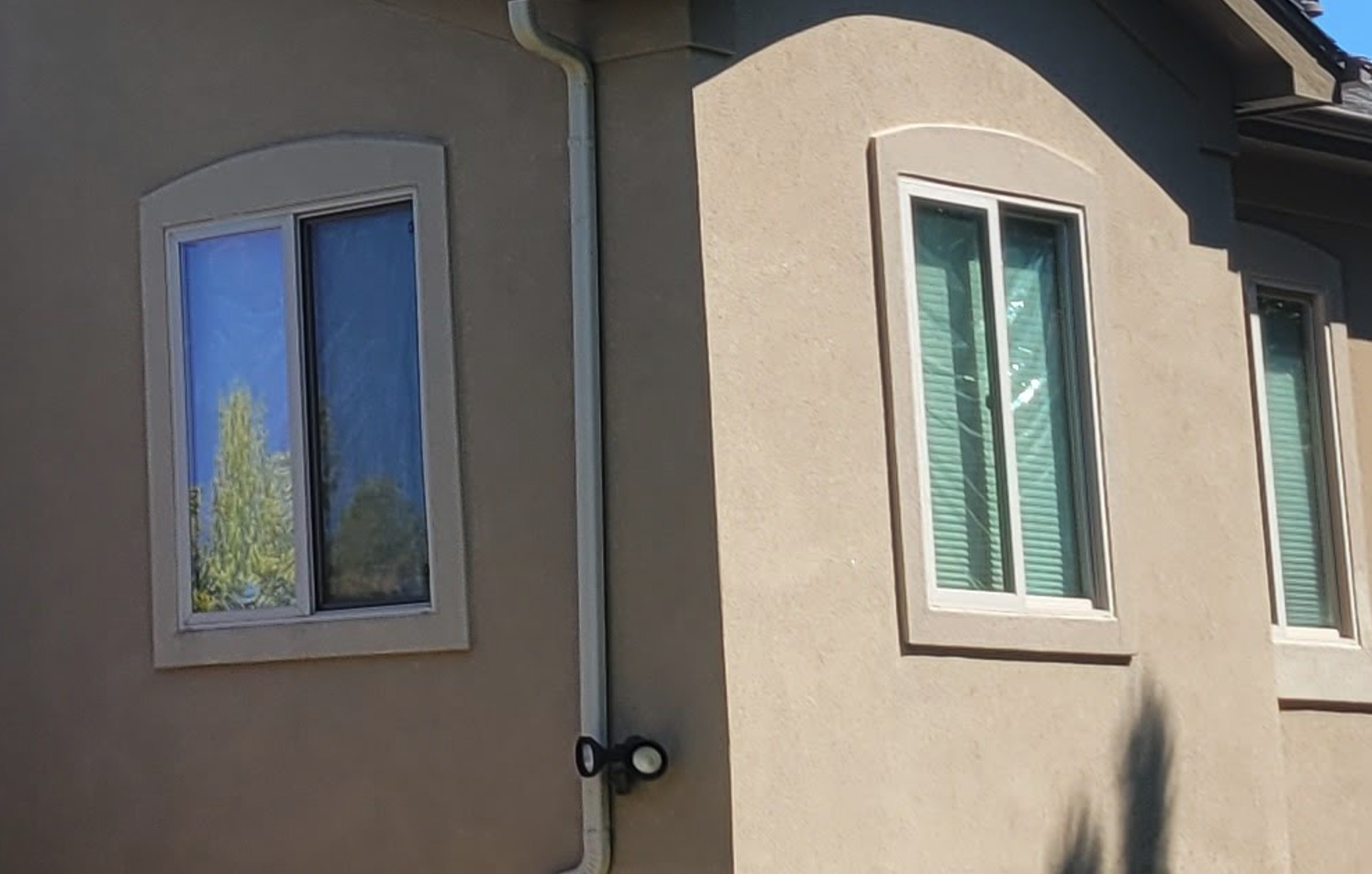

We have lived in this house for 17 years and the first winter the 3 windows in the picture were leaking it felt near the bottom. The one in the midddle was the worst. The house was 3 years old at the time and these are quality windows
I sealed them with the plastic you can see in the pictures and that took care of it and I forgot about it
I was reading that the first fix is to caulk the inside and outside of the windows. Stucco can make that more of a challenge

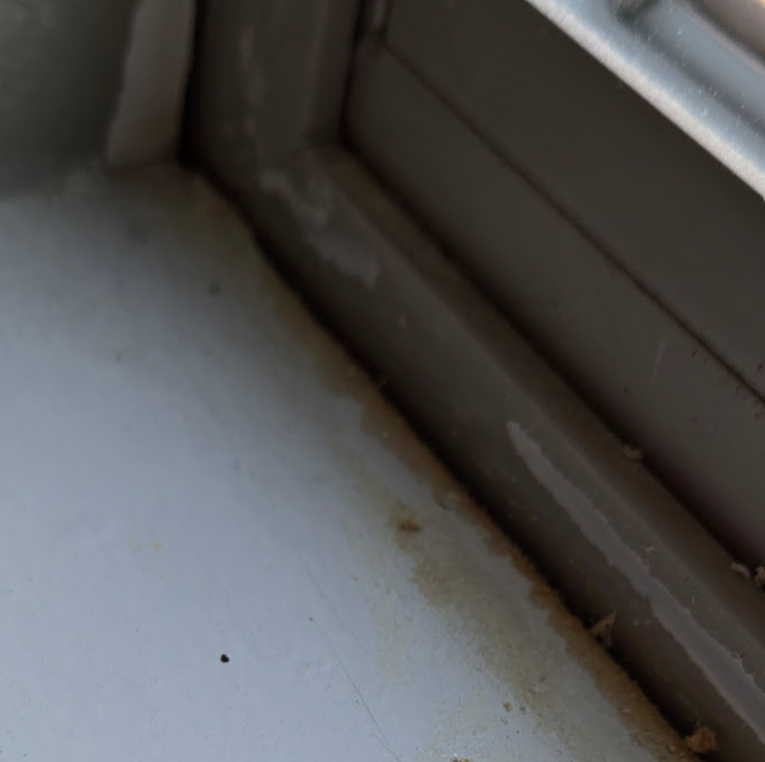

Not sure why it took me 17 yeears to dig into it, but thinking this may also be an issue
You will notice gaps at the bottom and side on the inside of the window Frame. I don't think the window runs in that
I have looked at other similar windows and they have a similar gap and they are not drafty
Planning on caulking the outside with something suitaable for stuccu and the inside. Would it be wrong to caulk these areas?

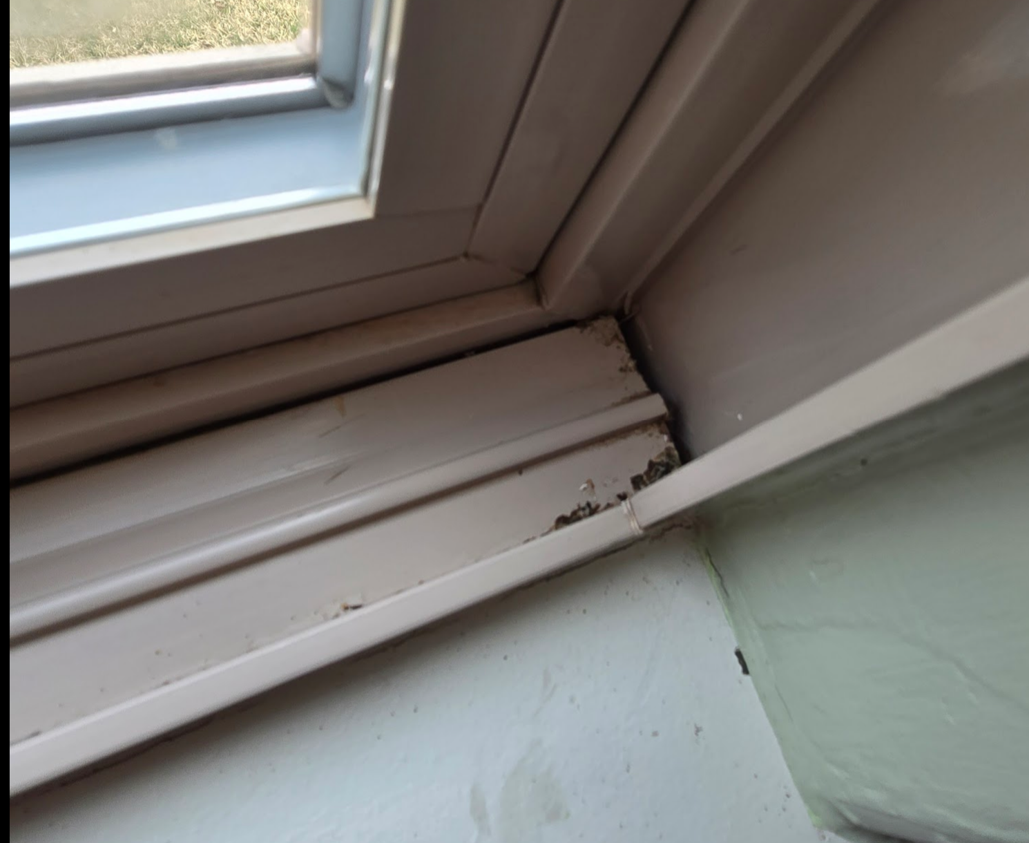

Have you considered lifting that piece out to see what’s under it? Also have you looked at it when it is super hot? I feel like it could be loose in winter due to being an expansion strip, but that’s a total guess. If it is, then it would likely need to be caulked underneath, but that’s piece stays loose so that it can float.
Again, a total guess

Not sure how I would lift that peice out without taking the window out
With the slider towards the middle of the frame the slider should lift and then you take it out from the bottom and set aside. Use some hooked object (pick? bent wire?) to lift at that gap.

Broadly, You will know what is there as opposed to guessing.
If both sides slide, both are removable. Often only one slides and I cannot tell from the pictures.
What you find will vary. Almost always a bunch of dead bugs under it.
You should see some openings in the vertical divider between the inner and outer tracks. Those are drains. They should be clear. Then, on the outside of the frame there are usually little flaps that allow water out. Rain hits the glass, runs down the surface, some can find its way into these tracks, and then drains. If no little flaps, that could be a source of incoming air.

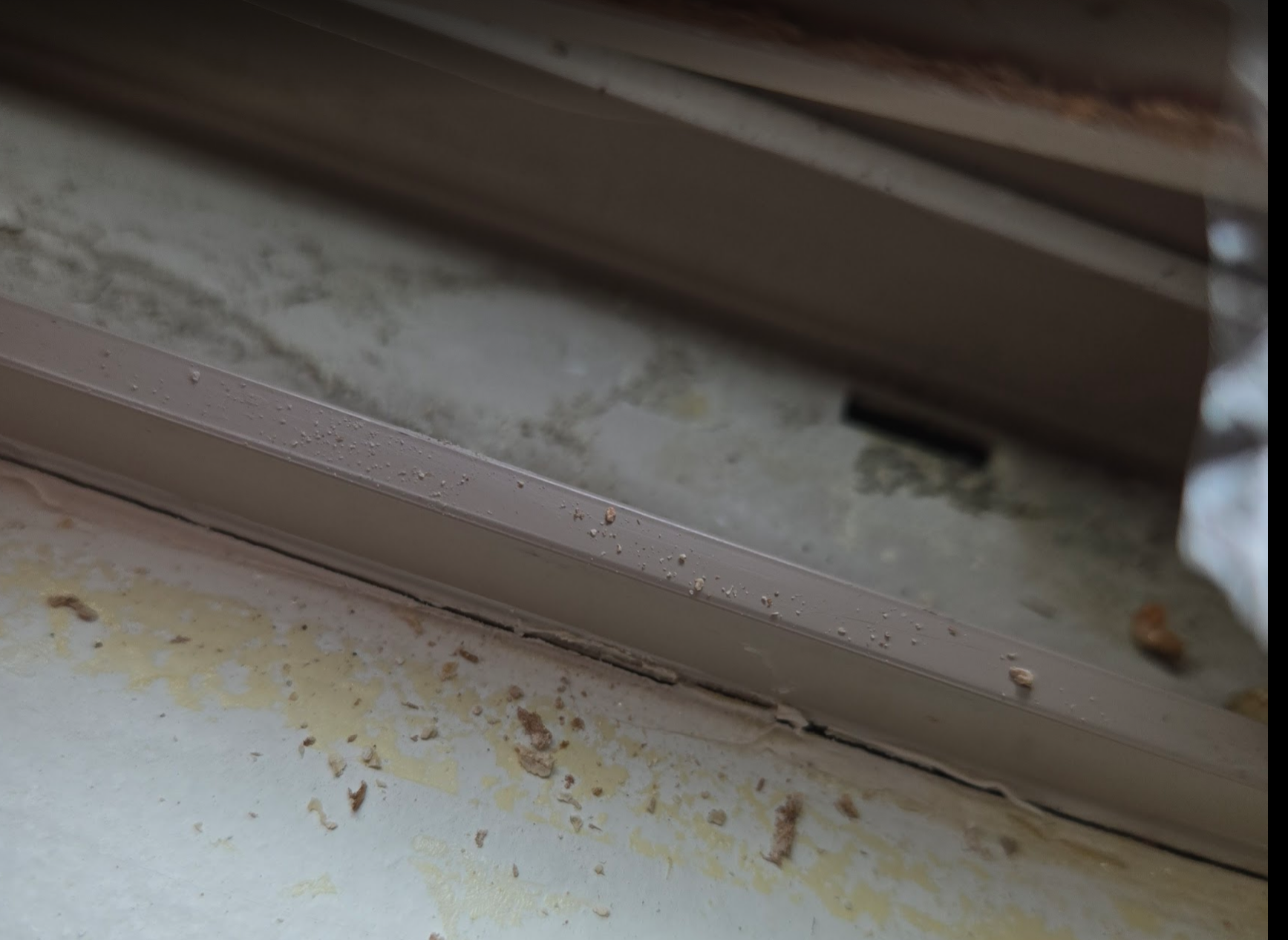

Using a pick I did pull up the bottom trip and its a solid peice except for the drain holes. So Caulking that wouldnt have done anything other than blocking the drain path
I still can caulk where the window meets the sill though as you can see some seperation there

After removing the caulk, I noticed on one side of the window, I could only get the tip of the pick in there. On the other side, I could put the whole pick in and wiggle it around. It could be a gap from the install or just the way the sill was cut and installed.
I did try tapping the outside with a rubber mallett on the bottom of the frame and it didnt change anything. So I gave that side a thicker bead and tried to get some in the crack. I won't know until winter if it did anything and then I would just reapply the plastic that worked for 17 years :)
