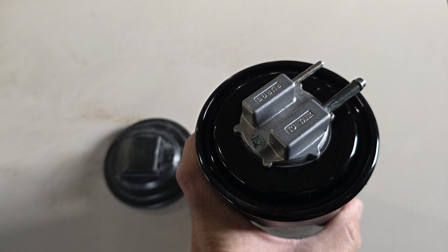

Have any of you guys ever taken apart a Toyota charcoal canister? I've come to the conclusion that mine is blocked, at least intermittently.
I thought it was a sealed unit, but what looked like a steel top is just a rubber cover that peels off. You can see it on the table in the photo below.

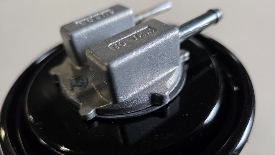

Looking more closely, it appears the top part with the ports may be threaded or pressed in:
I'm thinking if I could get that part off, I could replace the charcoal, clear any blockage, and clean the check valve. Before I have at this thing, can any of you shed any light on how it comes apart?

All those tabs imply to me it’s threaded in there. Try giving it a twist. Is the part still available? Our 80-series canisters are long gone. The 80 guys cut them apart to rebuild. I’ve been avoiding this task for a long time. I get the pressure in the tank.

That's what I was thinking, too.
No, these are long discontinued. You can find old ones on eBay, but I have an old one... I bought an AC Delco one that I might be able to make fit, but it'll be a kludge, so I'd rather fix the OEM one.

I was not able to get that canister apart. I still think that top piece unscrews, but didn't want to tear it up without a viable backup. I ended up blowing a ton of air through the thing, and replacing the tiny line between the tank and canister with one of more appropriate size.
