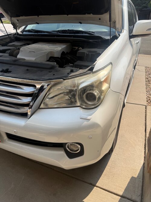

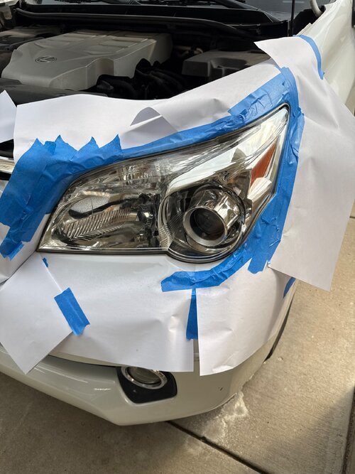

There some good information here. Instead of wasting my time buffing. I’d wet sand them, 800, 1000, 1500, 2000, then spray with a 2 part aerosol clear coat from the parts store. You won’t have issues for many years to come. I did this exact process on my wife’s old car and they still looked great a year later!
