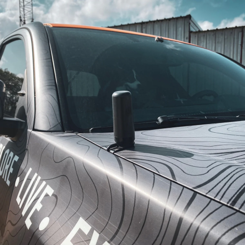

For example, this kit is $220 and has a reasonably good antenna that is low profile. It uses a lip mount.

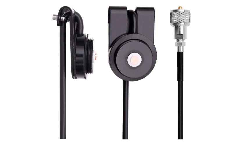

Does a lip mount just slid over a flat surface on a vehicle? I tried finding pictures but it wasn't very clear.

Yep, a lip is a clamp for the edge of your trunk, hood, or gate doors. Lip and magnet mounts are okay but all will collect sand and dirt and erode your finishes.
It's a pretty standard antenna sheet metal lip mount. You see them more often in ham and commercial radios as alternatives to mag mounts. The reason is it's slightly more secure and better for RF.
All mounts can damage something. Mag mounts can put small scratches if something abrasive gets between it and the paint. These use set screws to make them snug which puts a small dimple in the paint.
