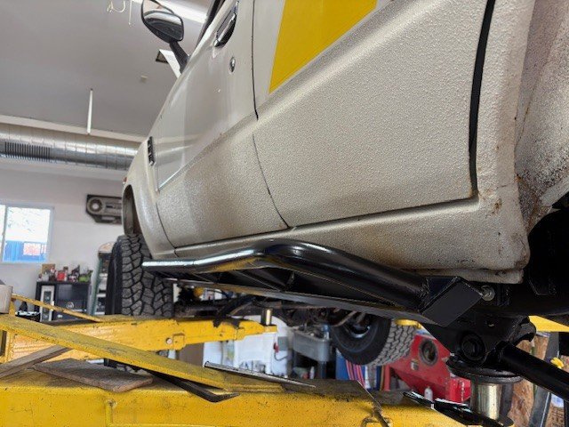

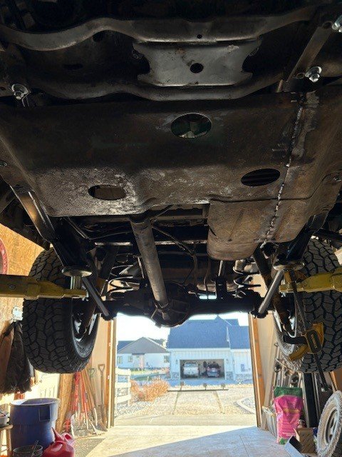

Got the sliders modified to fit the 80 frame over the past 2 days. Also took the opportunity to roll them up at a 20 degree angle. Also got the front driveshaft installed and the 60 series bash plate modified to fit the 80 series chassis.
I have been looking at rear bumpers with swing outs so I can get the spare out of the back of the truck. In measuring the 2 bodys I think a 80 series bumper might be my best solution since the frame is the 80. I was somewhat surprised to find that the 60 and 80 have the same width tailgate.

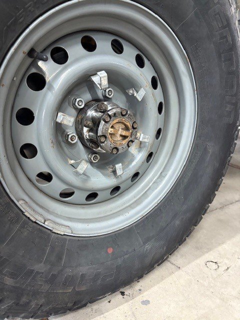

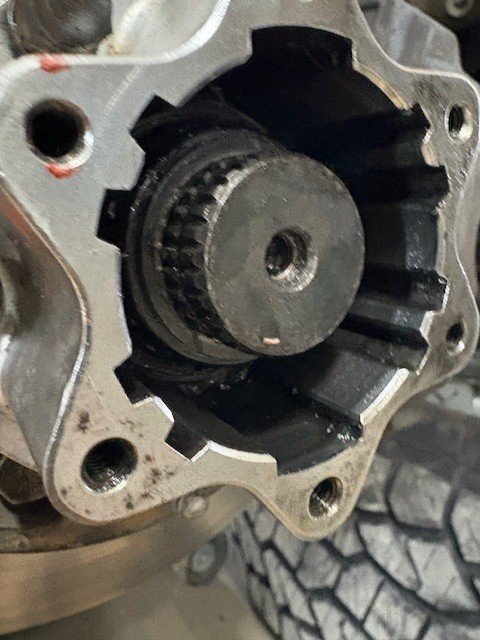

Pulled the Assin hubs off the 60 axle this morning and regreased them and installed on the 80 front axle. I had to cut in a second groove 13mm back from the end of the shaft to make them work. In doing research on Mud I found a link where a member posted their pictures of their part time 80 conversion. They used worm drive hose clamps on the axle as a guide for the 1/8" wide groove for the circlip. I followed this method with my 4" grinder with a 1/16" cut off wheel and it was a breeze. Wish I could claim this as my idea as it's brilliant.

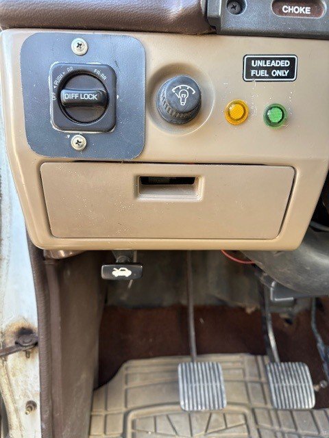

Locker wiring complete, thanks to @DaveInDenver for some assistance on completing this. The rig is now running a balanced desmogged 2F with shaved head, and a header. It also has the 4:1 low range Sumo gears in the split case and factory locked 80 series axles, suspension and chassis.
Next on the list is welding out the Coastal Offroad dual swing out rear bumper. It is scheduled to deliver by the end of the week, but due to the holidays it will be after the first of the year before it gets started. Can't wait to wheel this thing at Cruise Moab in April.

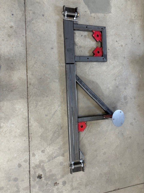

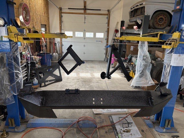

got about 1/2 the parts for the Coastal Offroad bumper. I have no idea why FEDEX would ship some of these direct to Denver while 2 of the boxes routed through Memphis. They are based in BC Canada?? Still missing the main bumper and the pieces to make the dual fuel can basket.

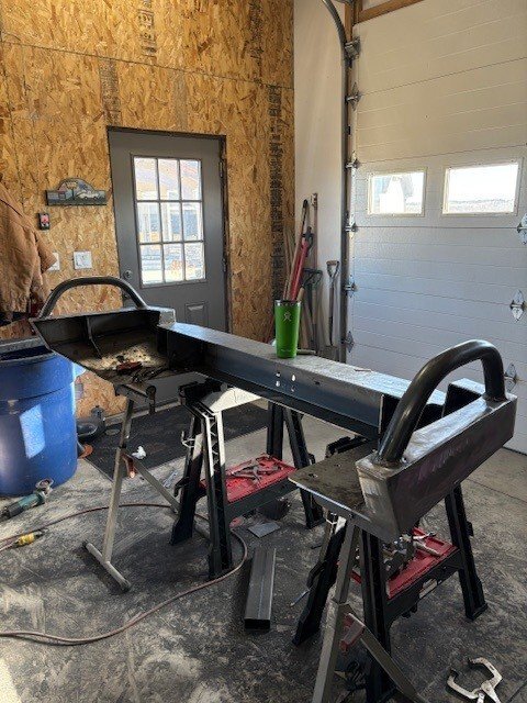

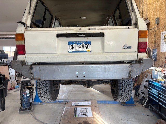

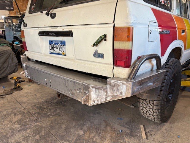

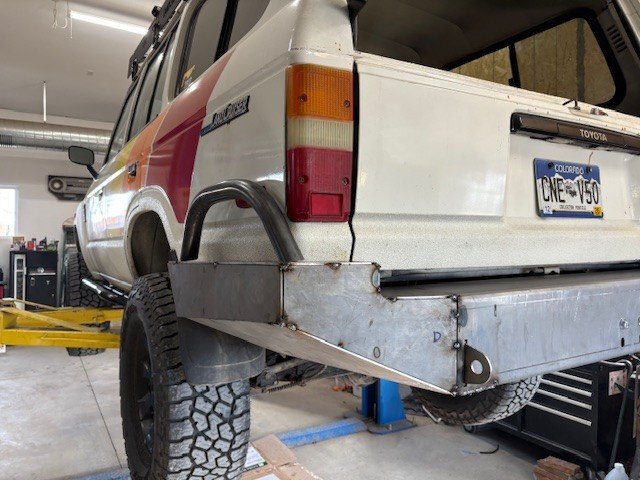

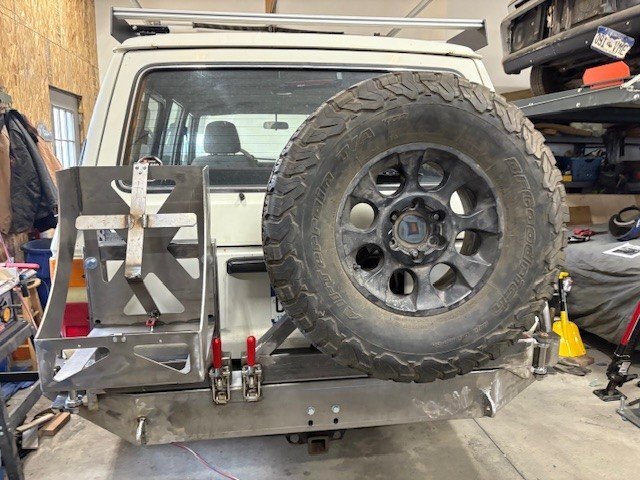

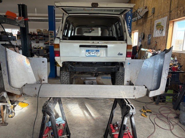

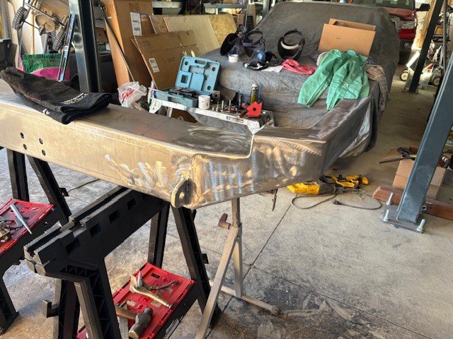

Got the rear bumper tacked up on Saturday. I will test fit it this morning and make sure everything is still aligned then weld out and grind smooth. I plan to shorten the hoops on the sides to just below the markers so they can be removed to change bulbs in the future. I have been very happy with the fit of the precut pieces with this bumper.

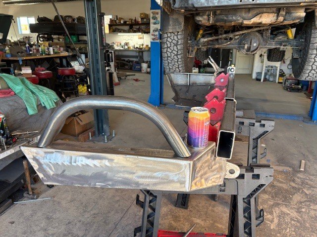

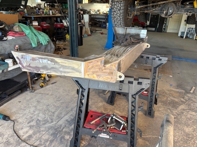

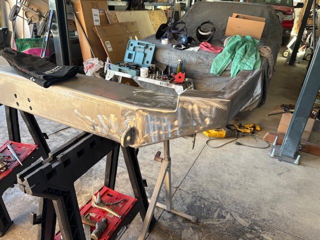

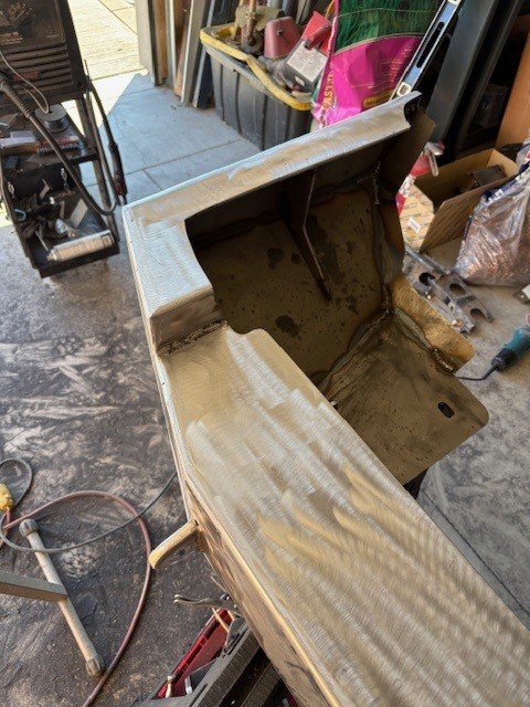

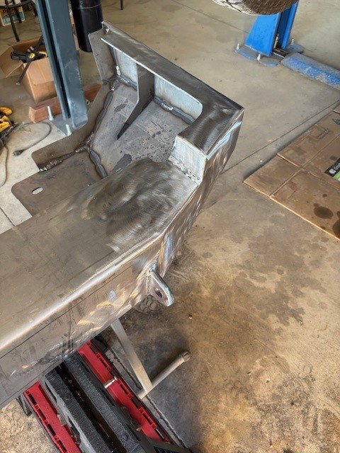

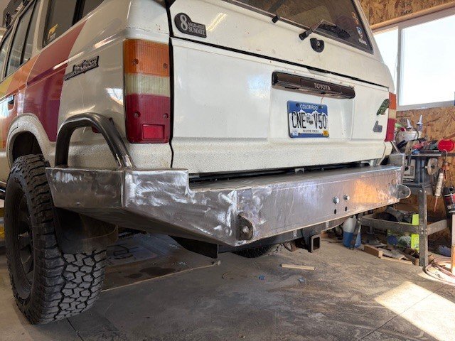

After 8 hours of welding and grinding I remember why I went into management in my 30's. This is hard work, but I'm liking the results.. Needing a few beers and Ibuprofen so I can keep at it tomorrow.

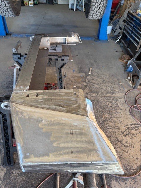

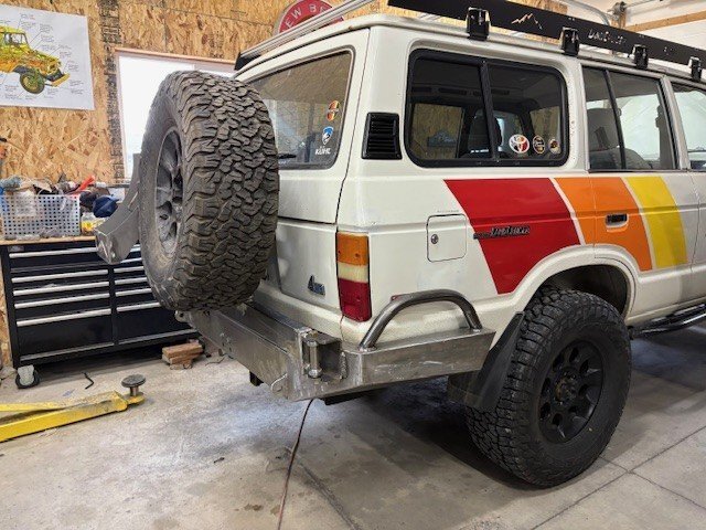

I finished up the main bumper today, then ran to my local paint supply store and got some black Raptor so I can coat everything once the swing outs are completed. Very happy how the bumper fit given I put a bumper designed for an 80 series on a 60. It seemed to be the best choice given the 80 series chassis. I decided not to cut down the hoops as they looked out of scale and the marker bulbs can be changed by removing the interior panel. This thing is a beast of a bumper built out of 3/16" steel.

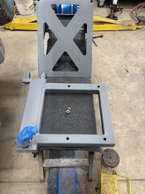

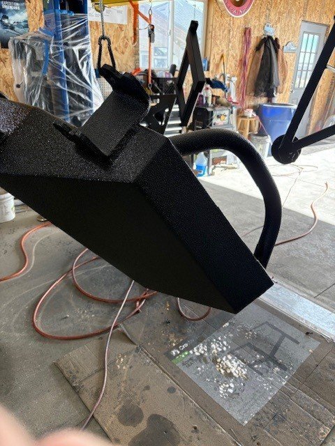

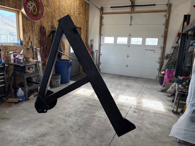

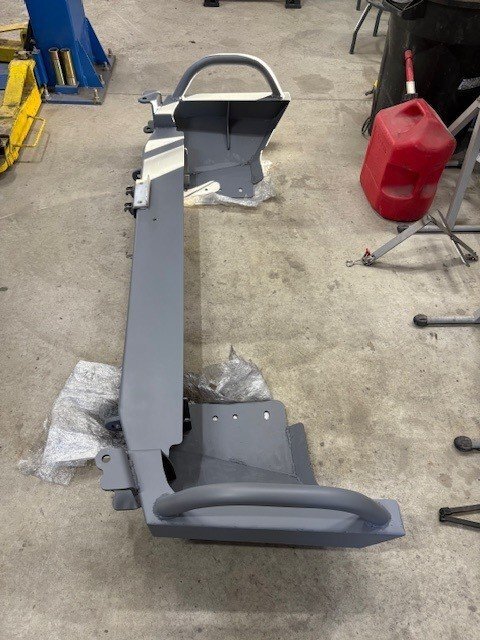

Got the main bumper and the fuel can swing out final sanded and in primer today. I'll give the primer a few days to off gas then prep for black Raptor and hopefully mount the new bumper for the last time. I also fabricated a mount for the high lift jack to store behind the spare.

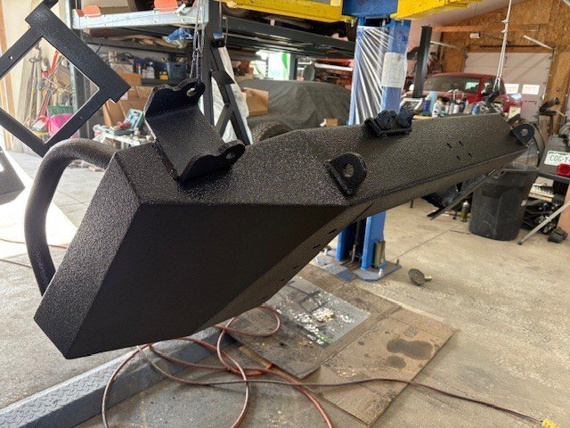

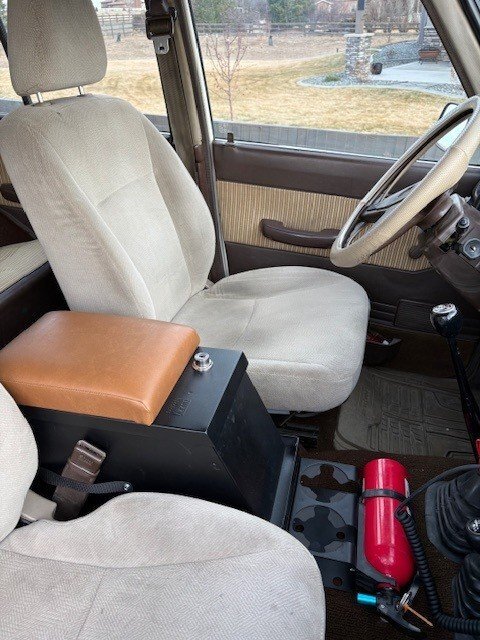

Got the bumper sprayed with 2 coats of black raptor today. I will give it 3 or 4 days to cure then mount on the 140 for hopefully the last time. I also installed the Tuffy center console that arrived this past weekend.
Getting close to having everything ready for Cruise Moab.

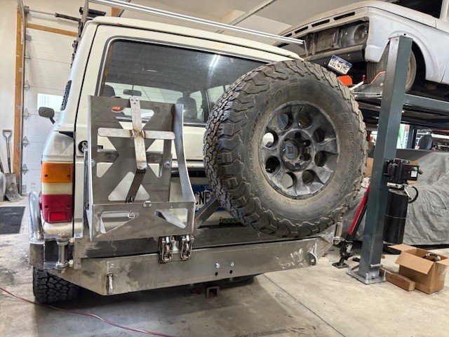

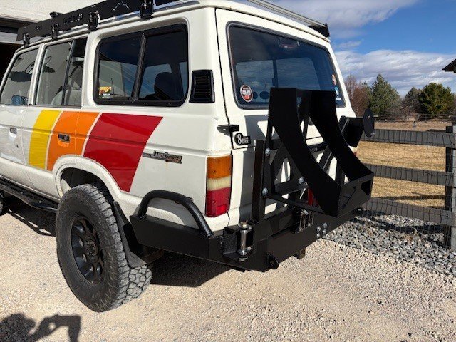

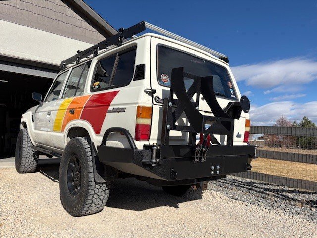

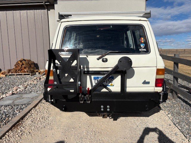

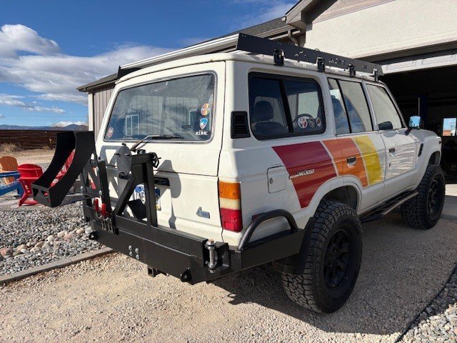

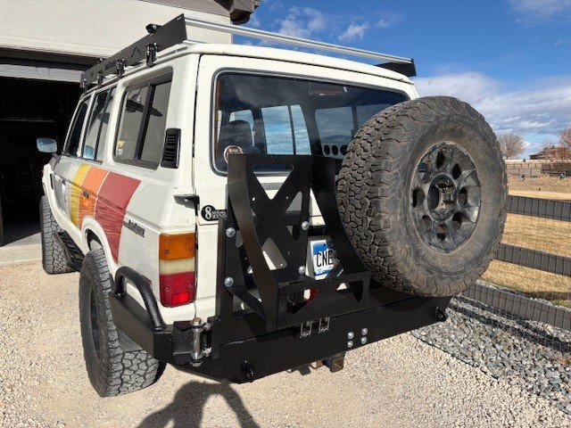

The rear bumper is complete and on the truck. It is going to be nice to not have that 35" BFG in the back any more. The bumper and the hitch look to give me great protection for the relocated 80 series fuel tank.

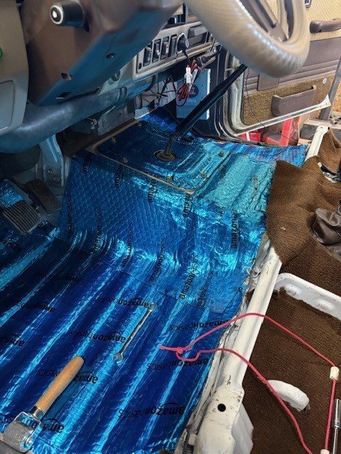

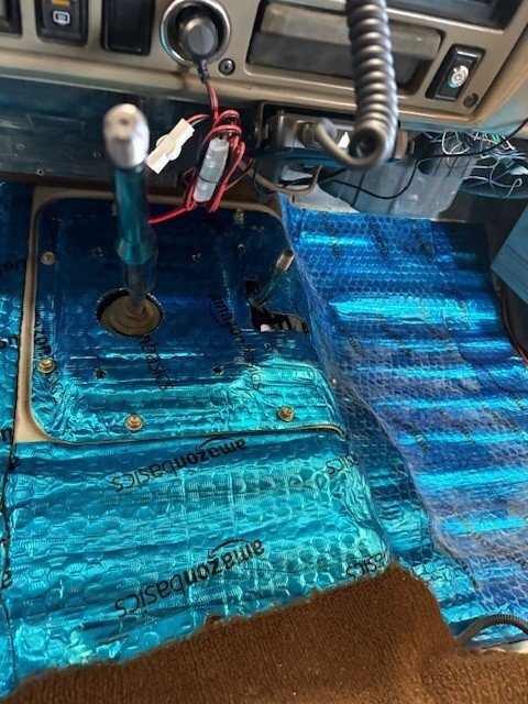

With the upcoming road trip to Moab I decided I needed to add a bit more sound deadening around the trans tunnel. Above 3,000 RPM the gear whine from the Sumo reduction gears was a little hard on the hearing. Did a double layer of sound mat on everything upfront. It has knocked down the noise quite a bit and should make the drive more bearable.

A bit of foam on top of the killmat style deadening will go a long way to help with noise. I noticed a big difference vs just kilmat. I could not get the heavy stuff I used for the floor to work well on the trans tunnel.
This stuff worked great for me. Keeps the heat down too. I have some extra if you are ever driving through.

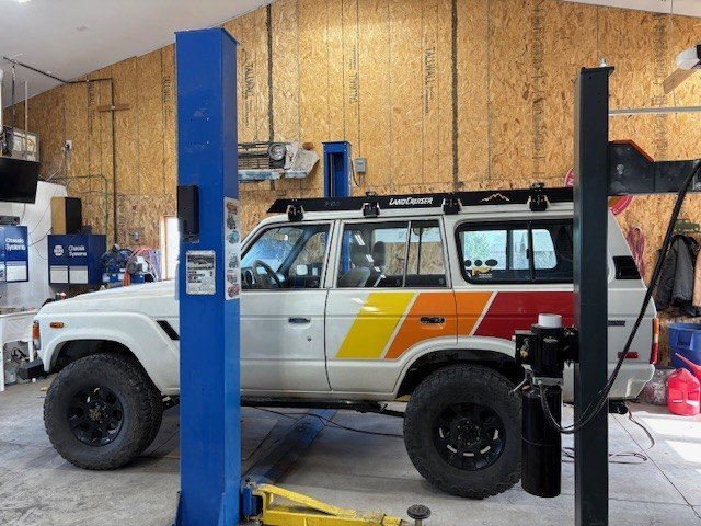

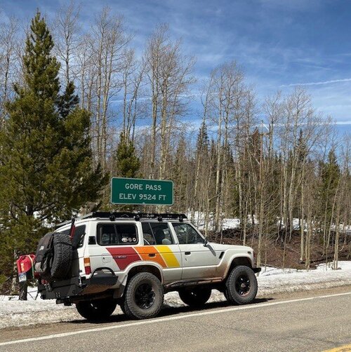

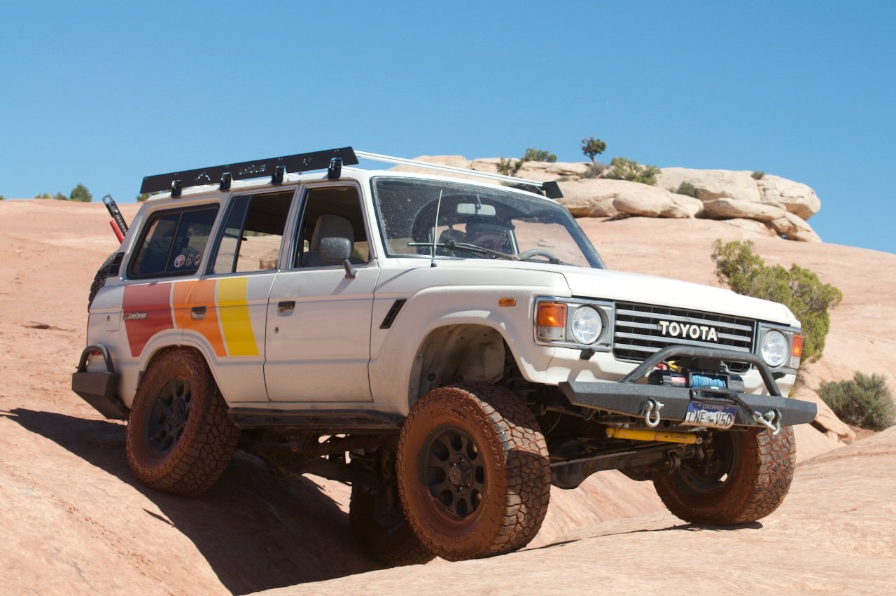

I took the 140 to the CM pre-run this past weekend and it worked flawlessly over the 950 miles of highways and trails. I was able to keep pace with the traffic up I 70 as well as scramble up the hard lines on 7 mile rim. The only minor issue is a bit of tire rub on the drivers rear when stuffed but that should get resolved by rolling over the pinch weld on the bottom of the wheel arch. I am delighted at the final results and looking forward to many years of enjoying the trails with this rig.
