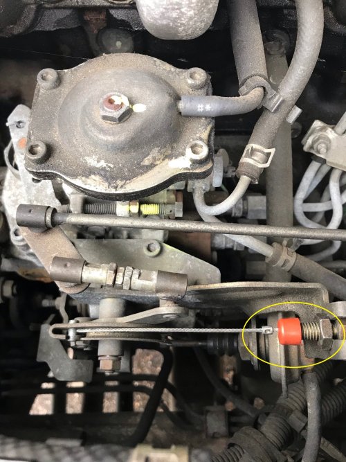

It’s a year later, emissions time again, and I didn’t do any adjustments to the fuel on the engine. Last year, my shift cable broke and I had to replace it. After replacing the cable I made more adjustments to the transmission cable for better shifting. MPG went up significantly, and apparently burning fuel much more efficiently WOOHOO!!
Are these adjustments made with the valve on the fuel pump? I’m looking to make some adjustments to my 1kz, any advice would be appreciated!

Last adjustment I made was to the transmission cable. I got it to pull just a little more and helped with the shifting and mileage. I haven't had any problems passing emissions since then.
