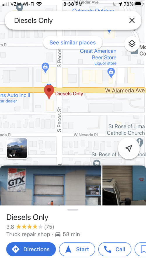

Matt’s last comment made me realize Diesels only isn’t an option. They only do 2wd.
Either way here it is, I was there Monday for another passing test on ‘lil smokey (Als Jetta)
I wouldn’t go get anything worked on there, seems like they aren’t great at actually fixing things and maybe screw ppl.
