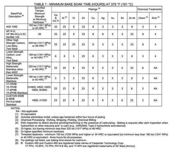

Hey Marco, I was thinking about trying this technique to derust an old crosscut saw blade. But, I thought I read in the link that you posted that it can make the steel brittle. Have you experienced this? Thanks!
9,712
Whoa, I just lost my post somehow...
fumble fingers I guess...
Yes, it can make the steel brittle if you are working with a harder steel. It's called hydrogen embrittlement. We deal with it a lot in our industry since the chromium coating process for our instruments introduces a fair amount of hydrogen to the surface. It's addressed by simply baking the part at 375F for 8 hours.
FWIW though I've read that the electrolytic rust removal process dosen't cause nearly the problems that the electrodeposited coatings do. I've not really seen anything on the web where folks have had issues with the derusted parts and I've read about them doing stuff like saw blades. It affects the harder alloys more.
I'll pull the SAE AMS spec for hydrogen embrittlement relief and give it a read a bit later on. It'll probably give a better definition of what materials really need baking and which don't.
I don't think I'd worry about it too much though.
Also, if you don't want to set it all up I can take it from you ar the meeting and stick it in my tank. It'd be pretty easy..
8,017
That would be awesome! Thanks man. I'm still not sure if I'll be at the meeting Wednesday since Kim is due on Thursday. I'll let you know!
:beer:
9,712
In case anybody was curious....
Here is the table with bake times for chemical treated, etched, or coated parts. Looks like the electrolytic rust removal probably falls into the "chem" category.
Also, in the spec it stated that these bake times only apply for materials that are 40HRC or 180ksi or more. Materials that are not that hard aren't as suceptible to hydrogen embritlement.
