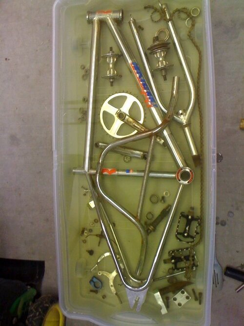

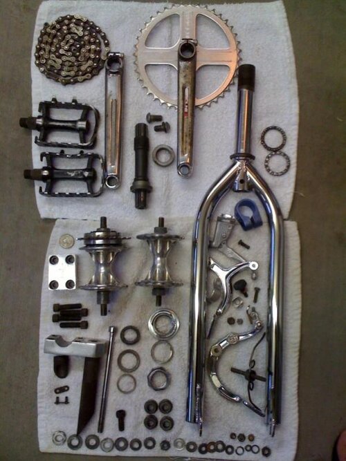

I achieved the same thing using citric acid powder.(you can buy it by the oz. at finer grocery stores, Here in Phoenix the store is called Sprouts Market) I used 8 oz. in this tub to clean up the surface rust on my old Robinson cruiser. Took it ALL off and left it shiny, without even messing up the frame stickers. I was really impressed after a 24 hour soak. No residue either. Just an alternative.
