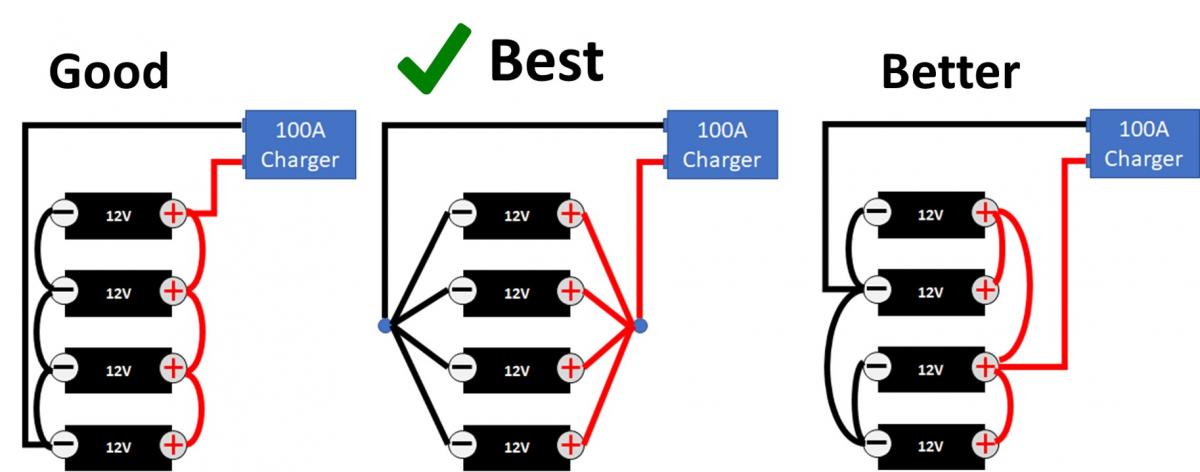

An alternator can only do its maximum. If you have one dead car battery on a 100 amp alternator, that alternator will output whatever the battery will accept up to 100 amps. If you have two or 10 dead car battery on a 100 amp alternator, that alternator will output whatever the batteries will accept up to 100 amps.
Just the same above time and voltage based method.
Same as above: An alternator can only do its maximum. If you have one dead car battery on a 100 amp alternator, that alternator will output whatever the battery will accept up to 100 amps. If you have two or 10 dead car battery on a 100 amp alternator, that alternator will output whatever the batteries will accept up to 100 amps.

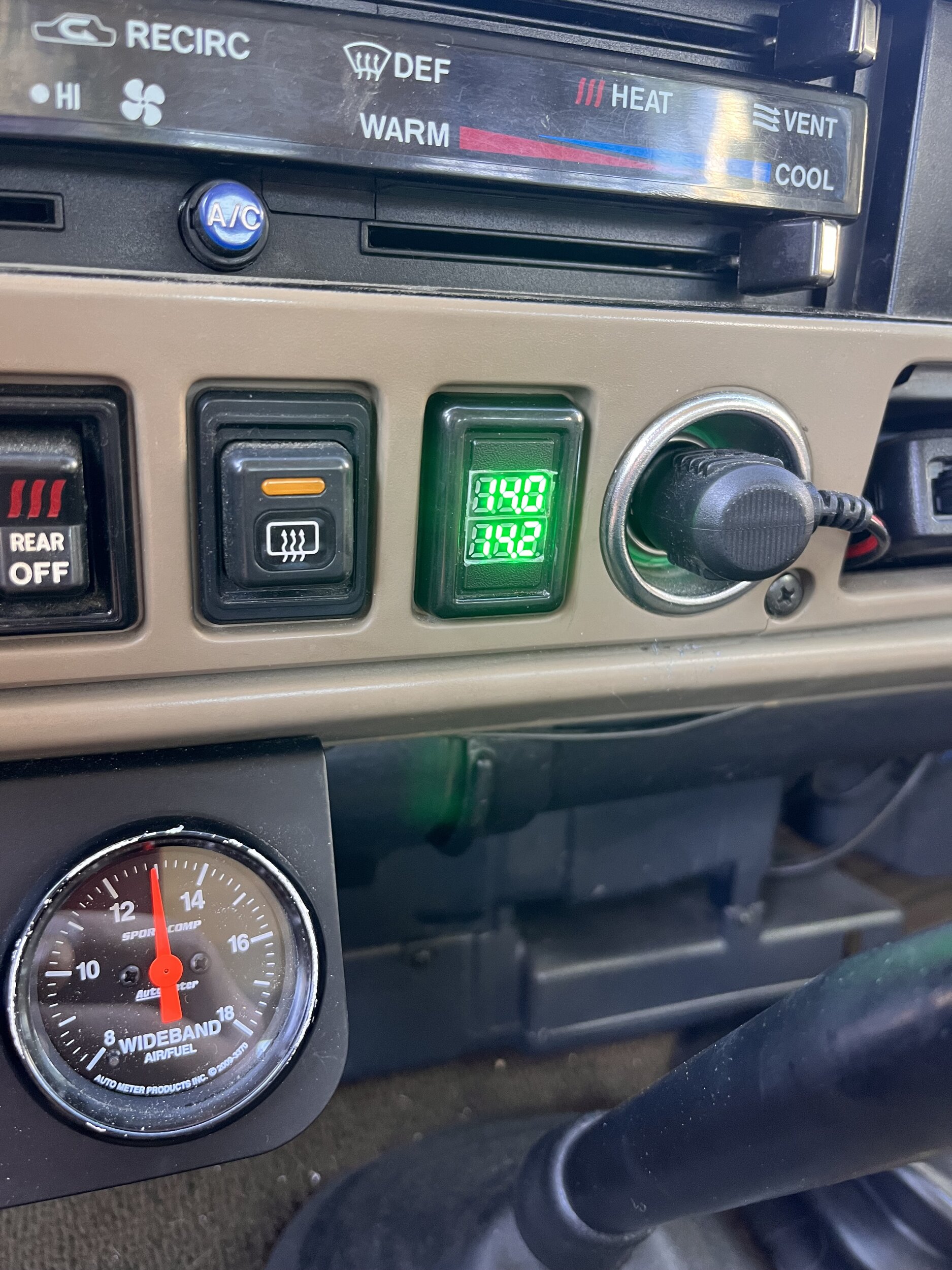

Ok I wired up the remote switch for the Blue Sea, and it seems to be working as intended. So I'm documenting this for myself mostly, as I'm probably gonna do this again at some point and will want to remember how I did it.
Those colors written above are what's in the wire that I used.
What confused me for a minute was the connection at the VSR... pins 3 and 8 (#1 and #4) aka blue and green get twisted together, connected to a + feed. I guess I could have jumpered those together at the switch, rather than run separate wires, but the wires are already inside the harness so I don't see how it makes a difference.
And pin 1 (#2) aka white/black get twisted together, connected to a ground. It's cool to hear the "click" of the relay, and see the lights on the switch correspond. next up is voltage display on the dash.
