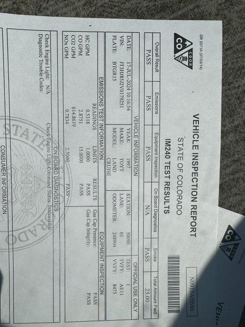

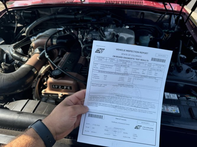

Turbocharged 1FZ’s emission #’s. Runs pretty clean and makes more power than a 2UZ! Should pass for the foreseeable future
Was this just with a turbo install or engine rebuild and turbo install?
JohnnyP
Jun 24, 2023
120
Broomfield/Westminster
This one was engine rebuild with turbo install. We’ve had several non rebuilt turbo trucks make it through the gauntlet without issues but I have not been shown the numbers just know they passed

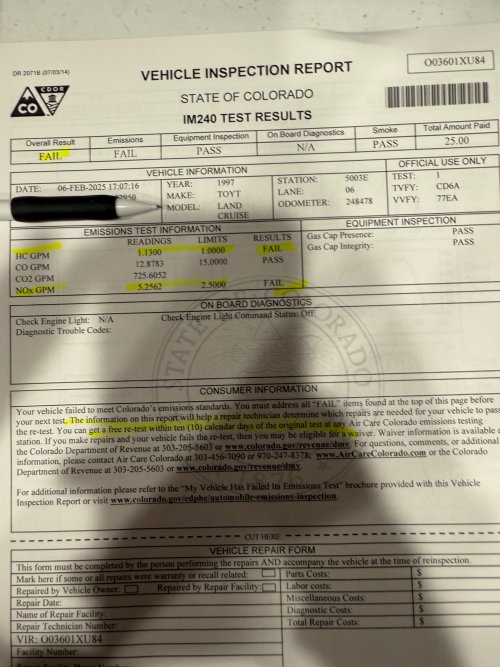

My turbo 80 failed for the first time in my 5 year ownership yesterday. Two years ago it had a new exhaust system with new cats and had the cleanest burning report I think I’ve ever seen. Now with both HC and NOx being high I don’t know where to start. Spark plugs cap and rotor I guess. I hope my cats aren’t done for already. I should take some temperature measurements
What turbo are you running? Are you burning/consuming oil? Timing advanced at all?
10,738
Safari Turbo system for the last 25 years. Nary an issue. Burns <1 quart every 5000 miles, so very little. Timing stock.
