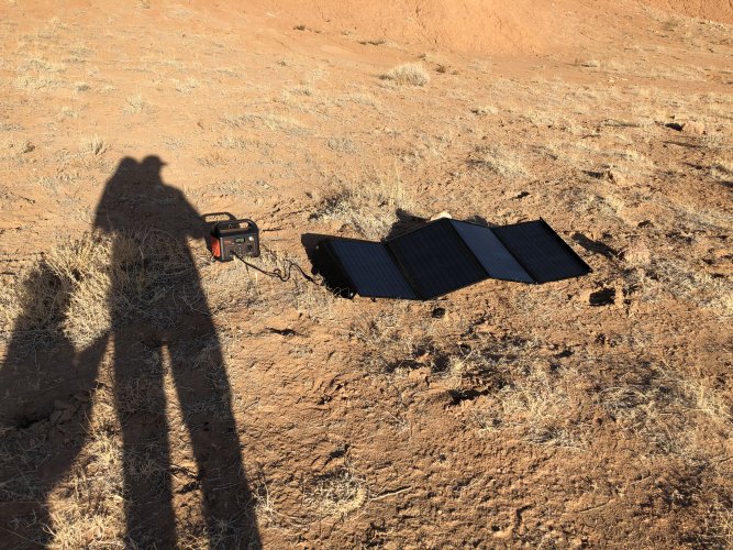

I have a jackery 300 and the 100 W folding panel a number of us got for a steal at $65. I mostly use this setup when solo camping or just out with a kid to run a heated blanket in the RTT, charge headlamps, etc.

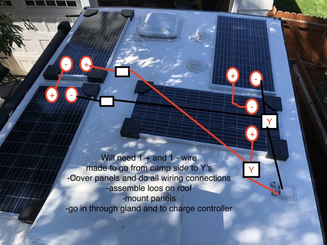

When we bought a travel trailer last year, the factory solar/batter setup was insufficient. Installed 4 x 100 W panels on roof (series/parallel setup) to a victron mppt to charge a 200 Ah LiFePO4. Turned off converter as it isn't necessary to keep us topped off. Battery comes inside for the winter. Maybe went a little overboard, but it was fun and we have enough juice for whatever we want. Not wired into the trailer's AC systems, but we really don't use those (AC and microwave). Will probably add a small inverter for charging laptops.

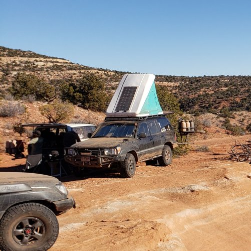

I laminated a thin renogy 100W panel to my RTT with just some silicone sealant in a few spots. This is fantastic for keeping up my house battery vs the fridge in summer and also maintains my set when parked outside for extended periods.
If I'm not running the RTT I can connect a folding set (the Rockpals shown above) of 100W panel and connect to the same controller.

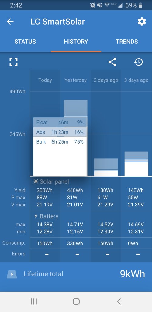

As a systems engineer, you should really check out the Victron controllers and related gear (it's more yacht tech / less Grampas RV, IMO)... mine tracks the history which gives me lots of data about my use efficiency and the overall condition of my batteries. (I'm using the SmartSolar 100/20 bluetooth and SmartBattery sensor with Bluetooth)
Controller app screen shot.
I've been on a few week long trips with this set up and it's been great. I plan my parking to get morning sun exposure most of the time, it's nice to see the output when in the tent and have the battery voltage available on the phone around camp.
