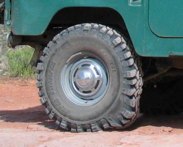

Doesn't Anyone think these tire pics look a little too photo-chopped? :rolleyes:
Look what happened to my 40 this afternoon! :eek: ;) :D

Man Martin that looks real cartoonish. Glad you were not hurt when it created the bubble.
I had the same thought when looking at the picture of the SSR. But it looks like the "bulge" ripped off part of the front bumper as well :hill:
