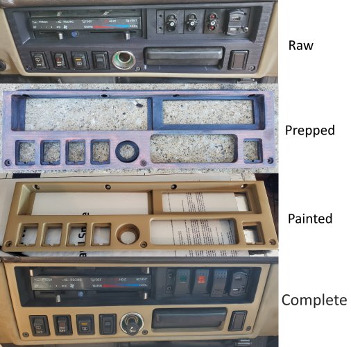

Well, it has arrived. I have some sanding in my future. I’ll need to find a rattle can with something that matches the caramel color of the dash.

Hey I just made an account here. I'm the FJ60 Solutions dude. I can say that I do 3D print these myself, Ive built my own enclosure with a DIY pain in the a** actively heated chamber. I programed a micro-controller and hacked into a space heater to keep the enclosure at a constant 50C to help prevent warping. The printer I choose can get the job done but there are some definite modifications that need to be made to improve longevity and improve quality.
At the time the CR-10 Max was the obvious choice at the time with decent online reviews. The warping wasent as bad as I imagined with the huge enclosure, Definatley easier to print in than ABS. As comparing printing a bezel to printing a radio bracket the only real difference is a slower printing speed and a larger nozzle.
For quality control I give each bezel a good twist before sending them out, I want any layer separation/cracking to happen while I still have the bezel in my possession. I do this for all my products. You should find that the bezel is very dimensionaly accurate.
I used up about 3kg of ASA to get the bezel to a point where it would be sturdy enough for production, and of course if anyone has any issues with their bezel I will gladly assist with replacement or a refund. I'm printing these parts to help pay for my College which I am perusing a degree in Mechanical Engineering, so a good customer service reputation is absolutely required to keep sales coming in. And I agree. $120 was way too cheap after all the time I spent getting this printer to work and material costs. what a nightmare.... But at the same time I know that my print quality wont be the best compared to other machines, and I'm still growing my reputation so I want to price things at a point where potential customers don't feel like buying from me is a huge gamble as I'm still in the "Building a Reputation" phase.

Don't be afraid to take a power sander to this bezel! It speeds things wayy up.
