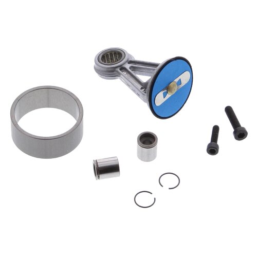

Maybe this video will help visualize. It looks like there's a design oversight with the axle on which the piston rod rides. It looks like it can walk as the needle bearing wears and it looks like ARB addressed it at some point. Looks like you can get the parts to retrofit and rebuild it.

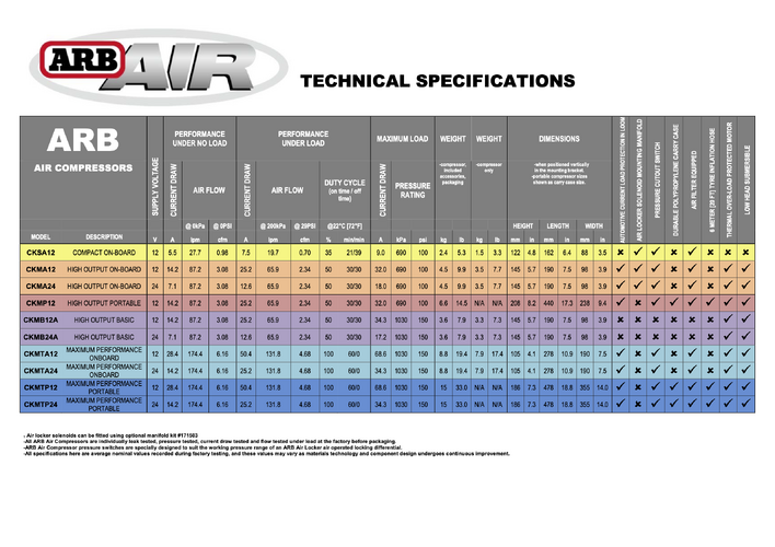

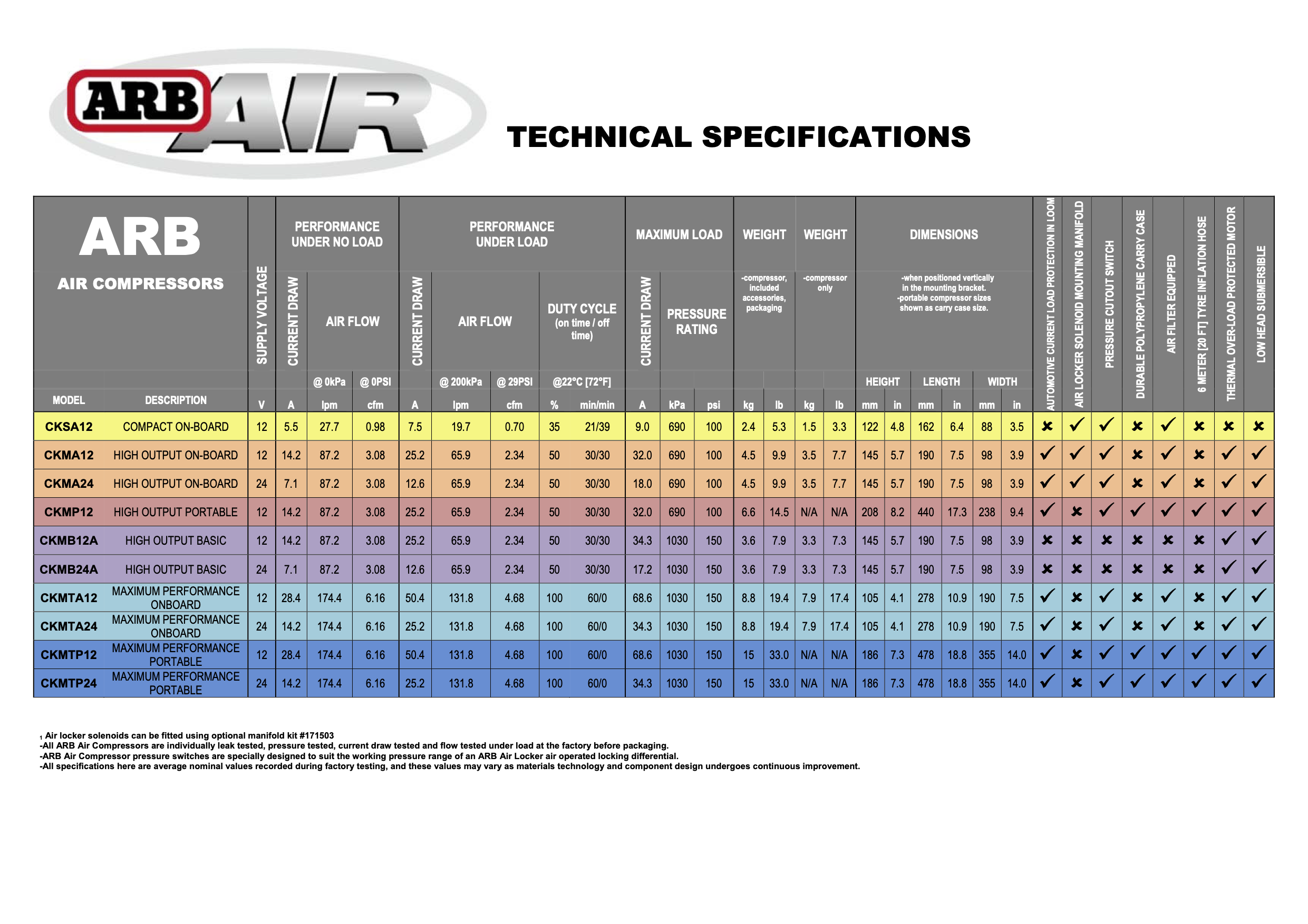

A feller doesn't have to rely on Steve's impeccable intuition on this. ARB still sells both due to presumably price point projection plans.
The CKMA12 is a 50% duty cycle, 30 min on, 30 min rest compressor that can do 2.34CFM @ 29 psi that ARB sells for $360 now.
The CKBLA12 is 100% duty cycle that can do 3.10 CFM at 29 psi that ARB gets $560 for now.
The question I'd think at hand is what are you willing to spend, Paul? You could rebuild yours to the improved piston and rod bearing for $60.
This won't fix the duty cycle and flow characteristic differences but should solve your problem. If you have no real complaint with how it was working I know what I'd do, spend the $500 difference on brain cell killing liquids. But I'm weird. I mean, it probably could be diagnosed. I just repaired a $10 bell I use on my town bike instead of throwing it away.

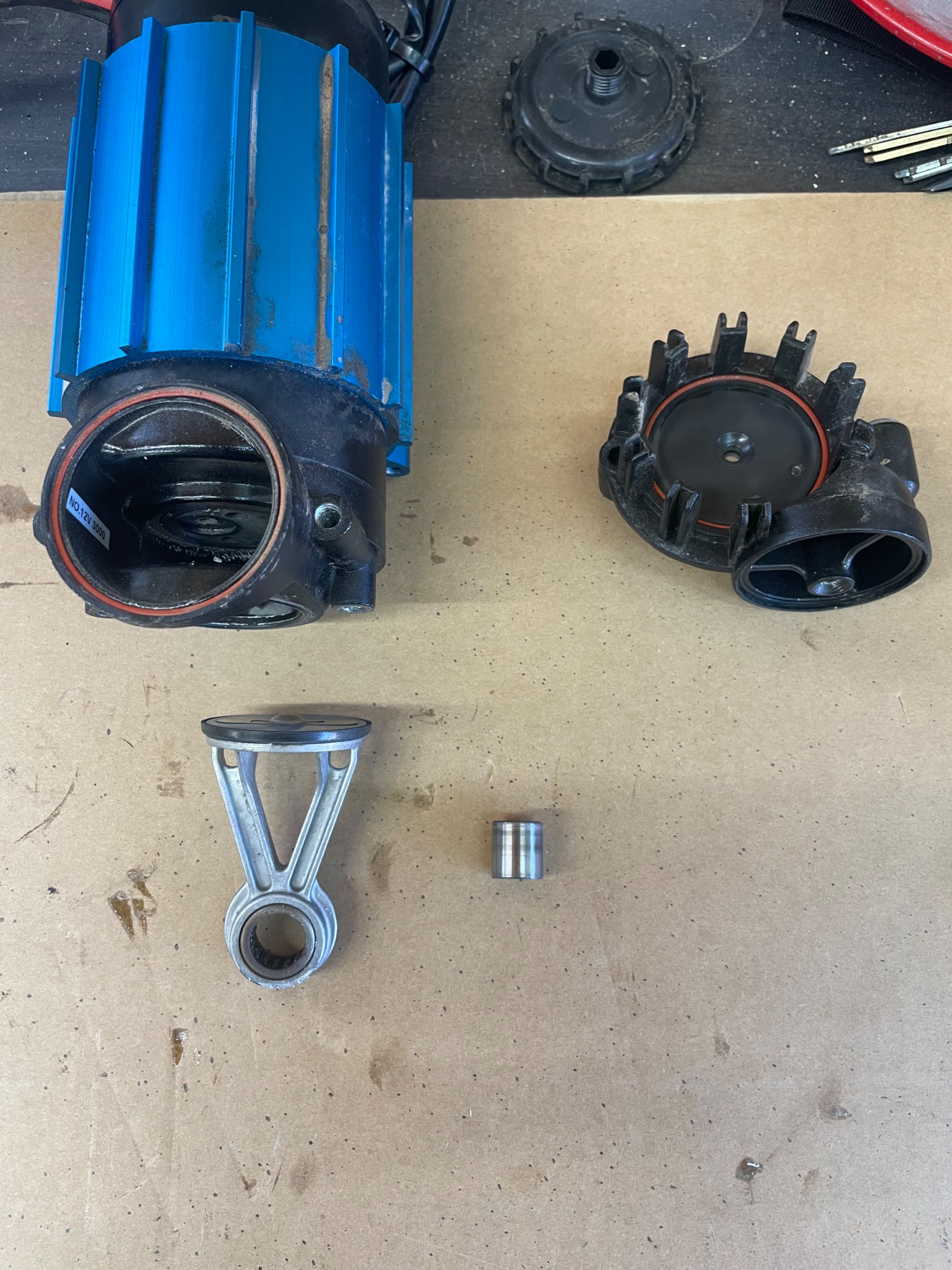

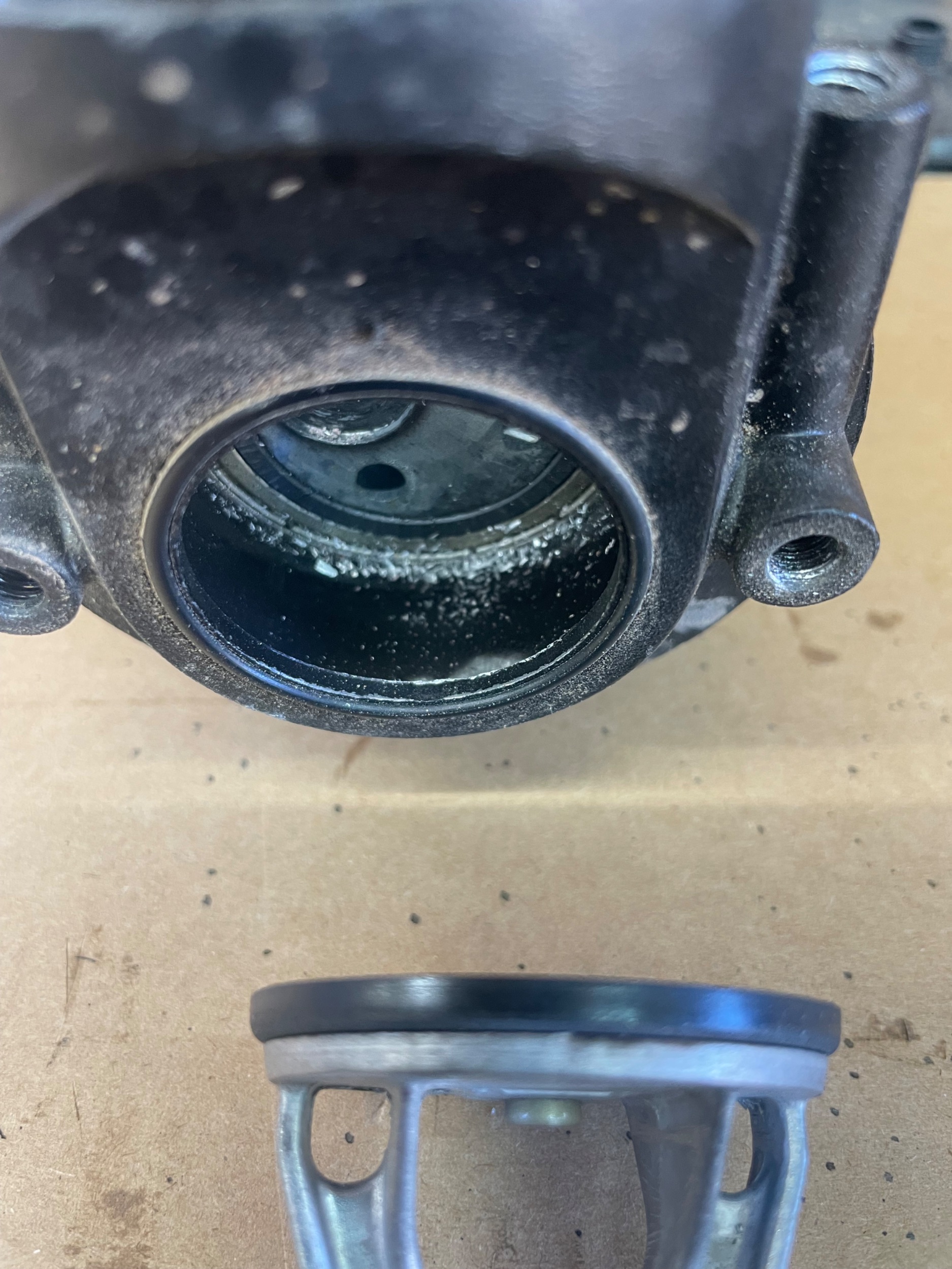

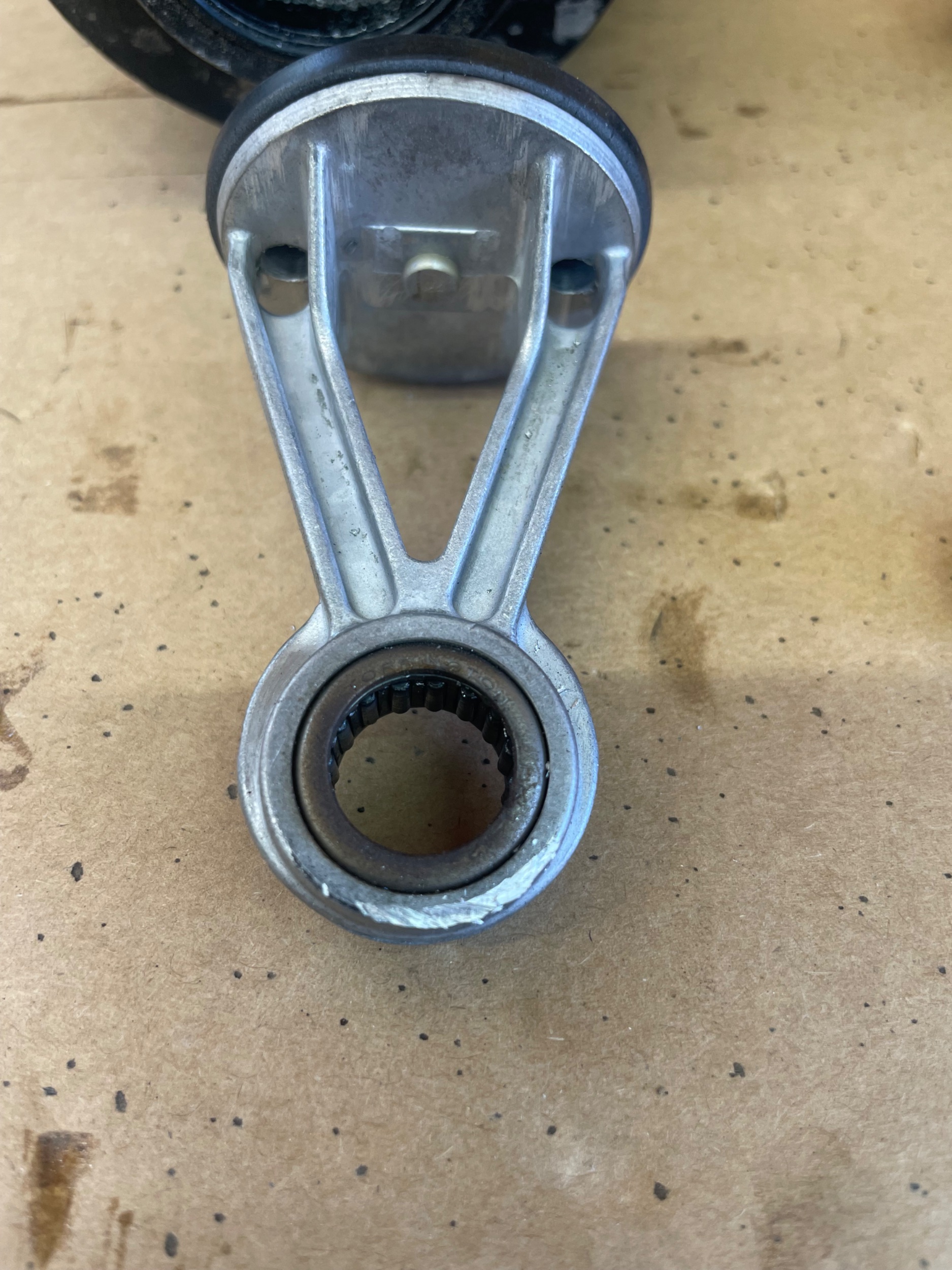

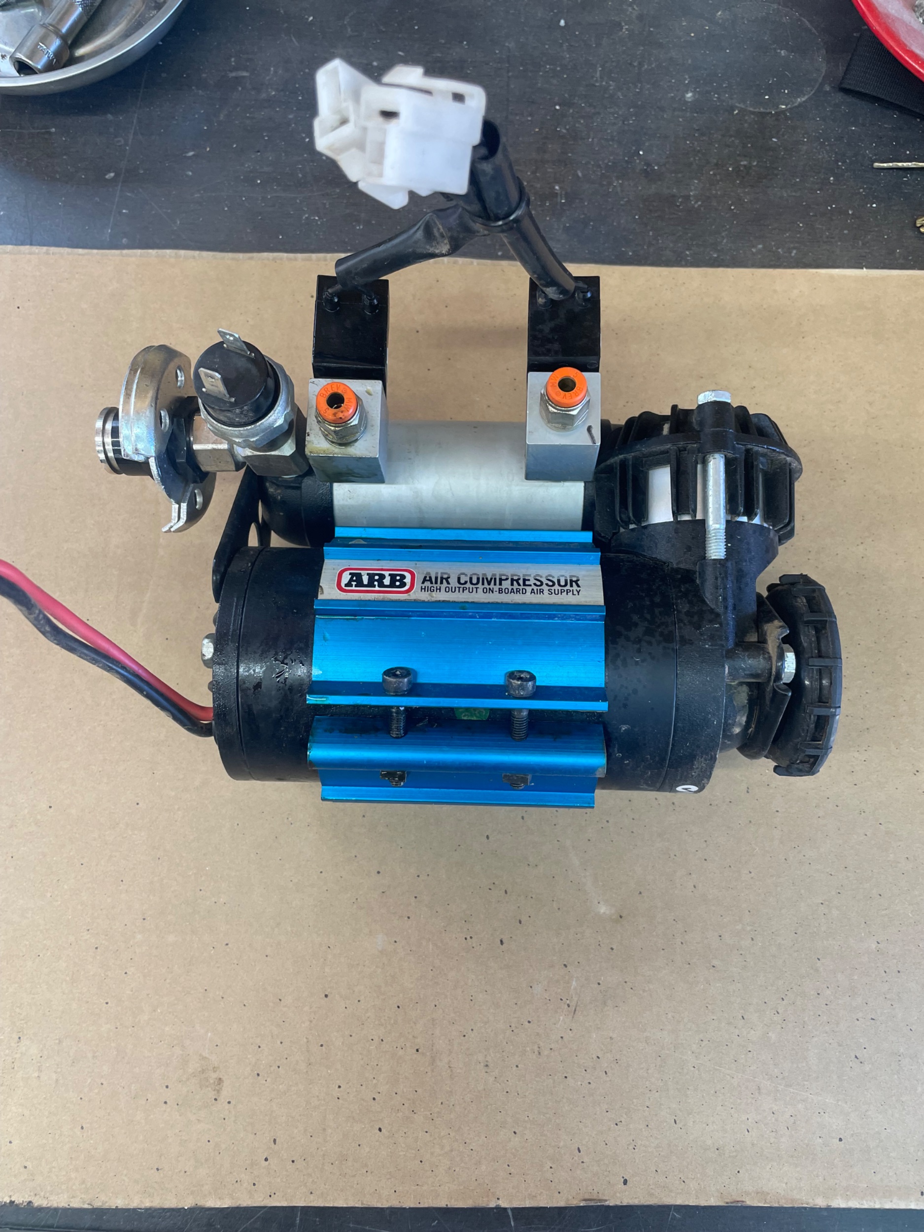

Yep….blown piston bearing.
Chewed itself up but nothing that can’t be cleaned up and a rebuild kit.

FWIW, after pulling this apart and seeing the bearing burn marks on the axle shaft I'd recommend at least pulling it apart, cleaning it and relube the bearings. Also, make sure your compressors were built with the new axle and retaining clip that keeps the piston rod in place. I understand they fixed the clip problem on post 2017 models.
