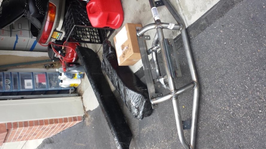

The bumper, tube doors, and sliders I ordered arrived today!
attachment.php
(pretend the photo isn't sideways)
Were it not raining right now, I would do a test fit of the bumper and tube doors. :rant:
My plan is to paint the bumper black and the doors the same color as the body (Light Topaz Metalic, 4E1). I haven't decided what to paint the sliders yet.
I'll probably do a self-etching weld-through primer for where my buddy with a welder will do some welding for me.

HoneyBadger
Apr 24, 2013
1,943
Pine
Nice!
That's gonna look good.
DouglasVB
2,392
Nice!
I think it will look good, too! :cool:
I'm surprised how light all of that steel is. According to the FedEx tracking information, everything only weighs 145 lbs. Taking off the stock front bumper and related hardware and the stock doors probably will be about 50-70 lbs of weight. To make up the rest of the weight difference, I'll jump on a tread mill more often :o
