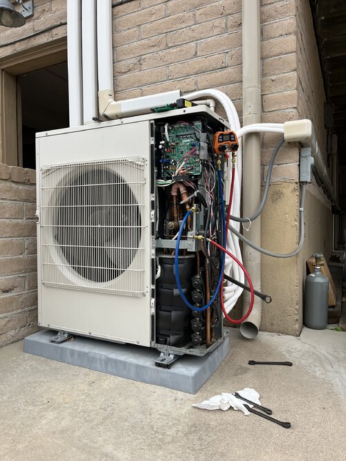

There is a valve stem replacement tool to replace it without breaking the system. If you are close to Arvada, can roll by and change it out real quick. Was just servicing the aircon on the house.
