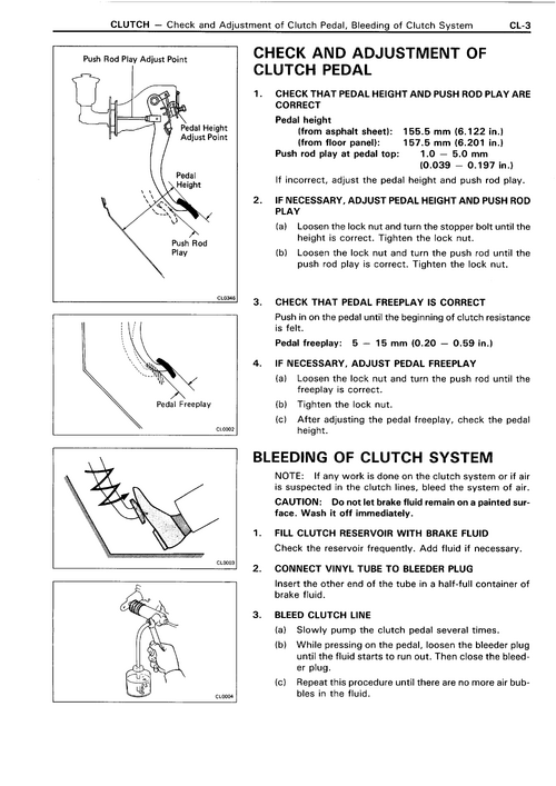

You've surely checked the free play. This from the 1988 FSM.

Thanks Dave the FSM pages. Looks like I have done what it says to do. I will need to check pedal play. disc goes in one way with this side labeled flywheel side. There is movement of the slave cylinder when you push in the pedal and I can move clutch fork till it stops and needs He Man. I have been driving it since I replaced clutch in May and even wheeled it pretty hard on the Spooky night run with no problems.

Update, Houston we have lift off. Thanks Dave the FSM helped out adjusted The clutch pedal to the clutch master cylinder and now have full pedal pressure and it drives great. Nice and smooth through all gears and even shifts into reverse better. My wife is happy to have her truck back again. Thanks to everyone for all the suggestions, took awhile but it’s done. Now I just need to figure out my clunking sound coming from my 4Runner. Dan

The push rod going into the master cylinder needed to be adjusted out so it would push further into the master cylinder Duh. Works great now.
