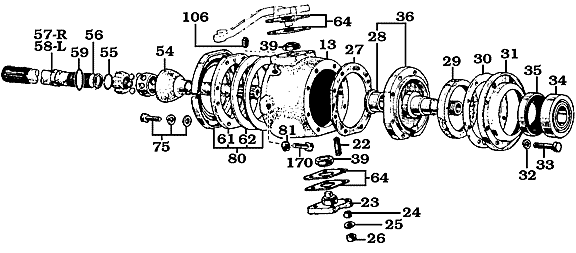

Of these two i need the circled one right?
Shark Bait
5,033
Parker, CO
Yes. You can separate them by dropping the inner axle through a piece of SCH 40 steel pipe. It'll come right apart.
You'll need some new c-clips when you put it together. That's part # 55 in the picture.
