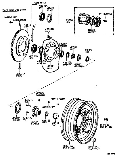

I'm in. I'd also like to replace one of my front axle hubs (#43511) that has two broken locking hub bolts still in it from when I blew the locking hub in Ouray. (Repaired on the trail thanks to Marco & Steve and a host of other hands too.) I tried to remove the pieces and broke off two easyouts in the process. Any other ideas?
I'll also post up in the For Sale/Wanted.
I used to break studs in my FF rear pretty regularly in my HZJ75 and developed some techniques that worked pretty well. In fact, I used to carry what I called my "axle kit" which consisted of parts and tools for repairing broken studs.
First, as you've noticed, EZ outs are pretty worthless, and breaking them off is bad joo-joo. Depending on how they are broken, you might be able to drill them out. To work on the end of a broken drill bit or EZ out, use a burr or very small stone on the end of a Dremel tool. If you can, first drill a small (~1/8") pilot hole as close to the middle as you can. Spray penetrating oil on it. Then, using left handed drill bits, drill successively larger diameter holes. Often, once you get to a larger bit size it will spin the spud of the stud out. If so, you're golden! If not, just keep going until your hole is just grazing the minor diameter of the hole in the hub. Then, very carefully, start chasing the threads with a M8x1.25 tap.
If the threads are buggered, plan B is to drill with the Helicoil bit (8.3 I think?), tap and helicoil.
I put you on the list Dave, but I would want you to have a replacement hub in hand, or have removed the broken studs from your current hub before the WBPP. I would hate to get your front end taken apart, run into trouble removing the broken studs and then have to just slap it all back together to get you home. Hopefully, someone can find an hub laying around - or you have some success with the approach Mr. Zepp outlined.
