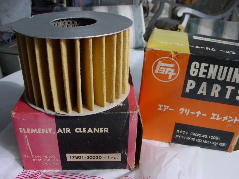

Just for future reference if anyone is searching obscure Stout stuff and come across this lame thread. 😋
I've been searching/researching air filter replacements since I got this. Mine looks to have the original. I finally found an aftermarket that is very close to oem dimensions. WIX 46181. ordered through O'Reilly and had in 1 day.
We'll see how it runs! This was not listed as a Stout part but cross referenced as Toyota deisel pickup, and gas Isuzu Trooper.
For reference, some pics and part number cross reference nerd stuff
