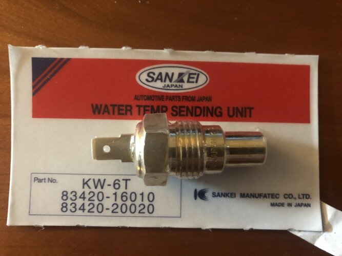

Came across this little gem the other day putting Toyota part numbers into auto parts catalogs.
Sankei KW-6T
Cost me $8 (total was $15 shipped and goobermint tribute) ordered through NAPA Online but I suspect any decent parts store could actually order it. The distributor who drop-shipped to me was Worldpac, who you've likely heard of if you worked in auto parts.
I believe Sankei is the Toyota OEM for this part. The 22R and 22R-E used 83420-20020, as did Corolla, Celica, Starlet, Supra, Cressida, Tercel, Camry, Corona, MR2, 4Runner, 40, 60, 70, 80 series, Lexus SC300, etc. Diesels, too.
The 83420-16010 returns a much smaller number of the same models. Looks like the part number changed around 1977 to 1980 for the different models. It's -16010 for 1969-1980 *J40/55 and -20020 after for all models up to 1997 *J80, I assume due to some sort of minor spec change or maybe a change in supplier.
Point would be that if your Toyota had a temp gauge from roughly 1969 to 2000 this was likely the sender.
You may have heard of them as Sankei-555, e.g. they also do our beloved triple five chassis parts.

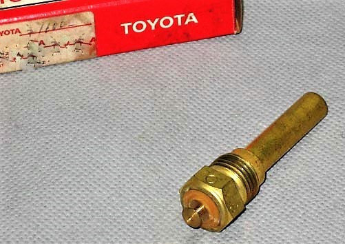

I don't know what year they changed, but my '71 sender (and dash gauge) is backward from my '76 and up. When open/de-energized, the gauge reads pegged-hot on the early sender/gauge, then when you start the motor it will go down and read cold until it warms up. The form factor for the early and late senders is the same.
Maybe the cutoff was the transition from F to 2F?
14,178
@Rzeppa, interesting. I don't know much beyond what the EPC returned for the part number.
Didn't those early FJ40 senders look completely different?

No, like I wrote above they have the same form factor. I swapped in a used F shortly after I got the rig and used a sender from a 2F and after I fired it up I noticed the temp gauge was backwards, to the right when cold and to the left when hot. I took the original sender off the original F and put it in and then things started working right. Lots of FJ40 stuff will mix and match, but not everything!

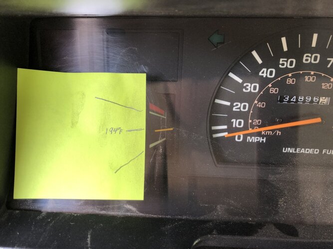

Alright, put in the 180F thermostat.
Also pulled the sender and tried a few tests on it. It seemed to match the new one at room temp (around 1.2k ohms) but when I dropped them both into boiling water the old one was giving odd readings. The new one fell right to about 81 ohms. They're expected to be about 25 ohms at 239F which I can't really test. So I just put the new one in.
I don't know for a fact that the old sender was bad but it seemed suspect. I was working outside and the rain clouds were starting to build and I didn't really feel like testing the old one, draining and filling coolant again to maybe just replace it anyway.
Sitting idling for 15 minutes it sits right where I'd expect.
The mark I put on was as close as I could get to a reading since I couldn't fit my camp stove under the hood in a place where it didn't seem like a serious risk to melt through a fuel line. So this is is the spot in time where the needle came to rest and how much my water had cooled (the temp is accurate, based on a Fluke DMM/thermocouple adapter arrangement). Close enough.
It's hard to really see but the view from the driver seat the needle is about one thickness below this line pointed down and with a 180F t-stat it seems reasonable. I didn't note it but the needle moves off the lower line at around 100F and 195F is basically flat.
So if this spot is about 10ish degrees below 195F (give it a generous +/- 5 degrees from 180F) I was running an indicated something like 205-210F (very approx) when it concerned me, although with a suspect sender. It was essentially mirrored vertically, needling sloping up to the left. It probably wasn't really that near to overheating, although with summer yet to really hit who knows.
