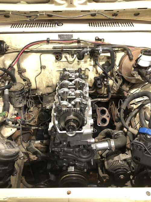

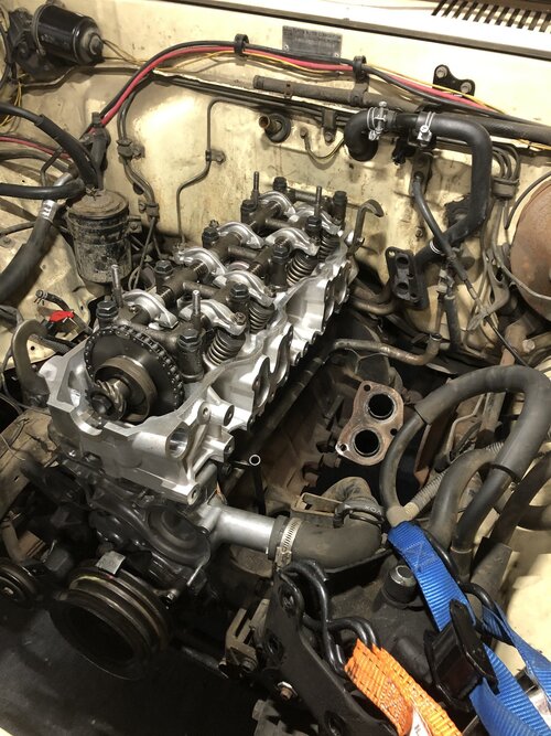

It took a bit of fiddling to get the distributor set right and stay running.
I want to believe. But.
Compression
#1 = 165 psi
#2 = 160 psi
#3 = 160 psi
#4 = 155 psi
Head bolts all click at 58 ft-lb, there's oil across the valve train when I took the cover off.
Set the valve lash to 0.008" on intake and 0.012" on exhaust. This is of course cold. It looks to me like the right valves are tight and loose at the right cycle. #1 TDC #1 intake and exhaust, #2 intake, #3 exhaust. Turn one revolution #3 and #4 intake, #2 and #4 exhaust.
#1 was at the top when I set the head and lined up the timing chain bright links to the gear dots. I did not turn it until I had to do the second set of valves to set initial lash. So I'm pretty certain the cam is timing right.
I cranked it for about 2 minutes with plugs pulled before trying to start. It's filled with oil and coolant. Cooling system held 15 psi for 15 or so minutes while I was pulling the valve cover to look. No sound of leaking, don't see anything leaking.
Have not yet drained oil. The truck doesn't have an oil pressure gauge but the oil pressure idiot light is off.
Don't see any obvious smoke from the tailpipe. When I turn it by hand it feels and sounds fine.
