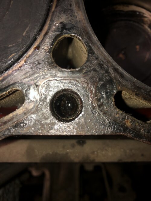

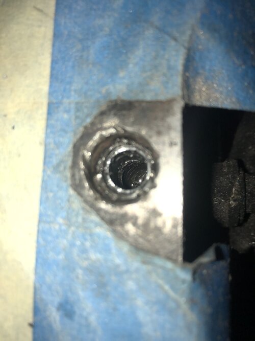

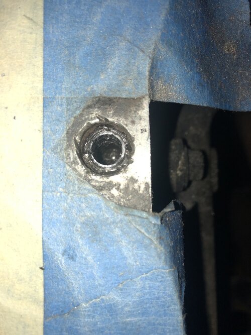

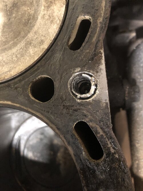

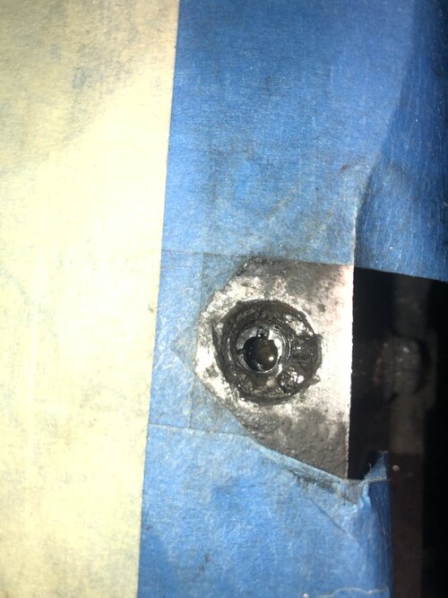

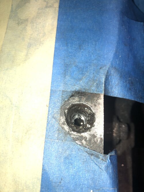

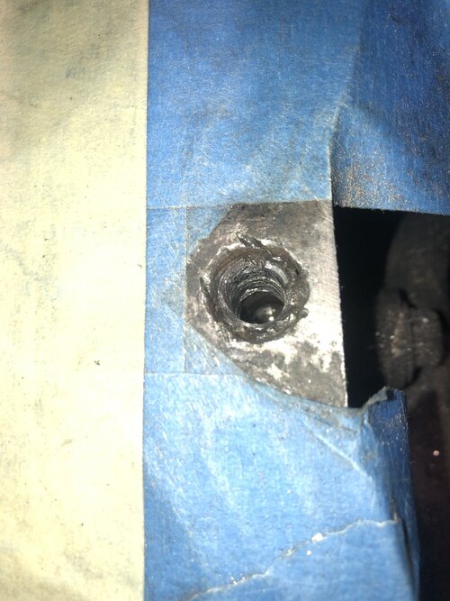

I'm now at the WTF stage. I opened the hole so that that last easy out would bite more. It was biting enough that material was getting shaved off. At this point I tried driving a chisel into the bottom of the hole, turning it with vice grips.
It's about 5/16" here and has a bit of taper from the easy out. Toyota started the threads a couple of mm down, so the tops of the holes are smooth at (or actually slightly larger than) the major diameter such that the bolts would drop before hitting threads. I'm probably very, very close to threads in the block but feel pretty confident that they aren't yet seriously damaged.

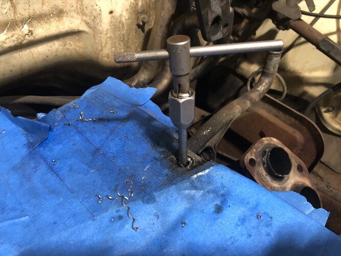

Then I went ahead and drilled all the way through the slug (there's a gap under in the pockets I'd guess of maybe 10mm when the bolts are fully sent) with a 3/16" and using a smaller easy out. It's grabbing maybe 1/8" up the spline.
I was guessing about right on depth. It looks to be about 15mm to 20mm of bolt left in the block. I was originally about 10mm down and it took about another 5mm to punch through.
It STILL won't release. I don't feeling like I'm turning that hard, but hard enough it should thread out.

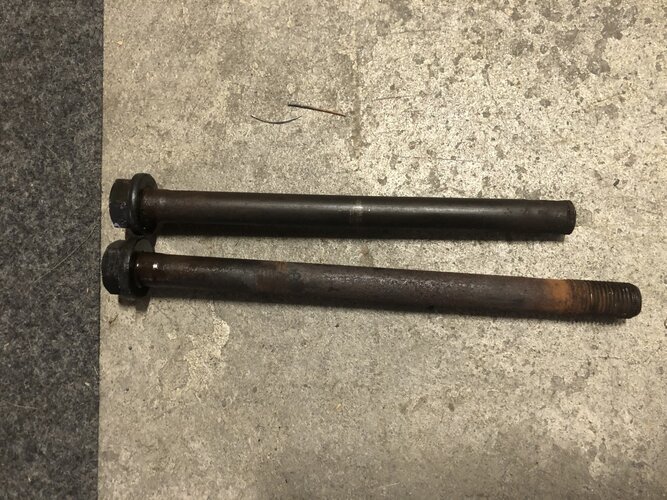

A good one for comparison.
A good bolt and the one that broke. The photo doesn't show it well but the broken one does have some roughness from corrosion or maybe burnt carbon at the end near the threads. Some of the others show evidence of rust at the HG level and there's burnt oil in places.

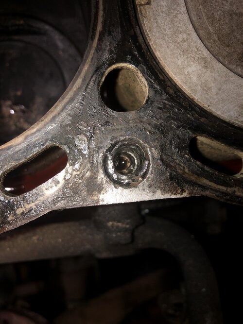

The bolt that I'm working is between #3 and #4 on the exhaust side. I haven't really done any serious cleaning but I don't see anything that jumps out as what failed. The HG came off without much effort and mostly intact.
My suspicion is the HG was leaking at #3 and the exhaust and heat cooked this bolt into place. That's only because #3 exhaust side on Imelda was also in bad shape, so sample of 1 to compare.
Whether it was turning at all or all I was doing was twisting it when releasing the head I dunno. The one opposite on the intake side is also rusty.

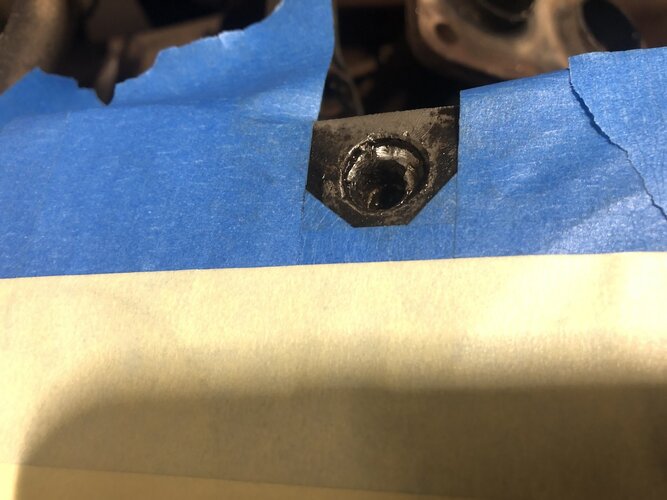

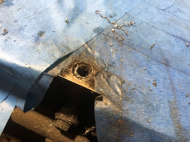

OK, I started trying to fold it over with a 1/4" pin punch and 12oz ball peen. Just took a few chips off the lip. All that is left is to drill it out?
14,179
Drilled it to 5/16" all the way through and starting working with what I got. If I can work the hole towards the middle and get it to 3/8" it'll either peel out or I'll just tap the MF'er in place.
