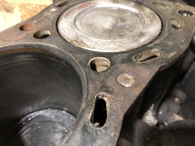

It looks small because it's about a mm or so ring where the block and bolt have corroded into homogeneity. I ran over it with a wire tooth brush already. That's why I'm paralyzed. It feels to me like it needs a machinist's attention.

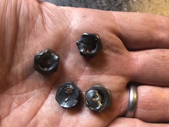

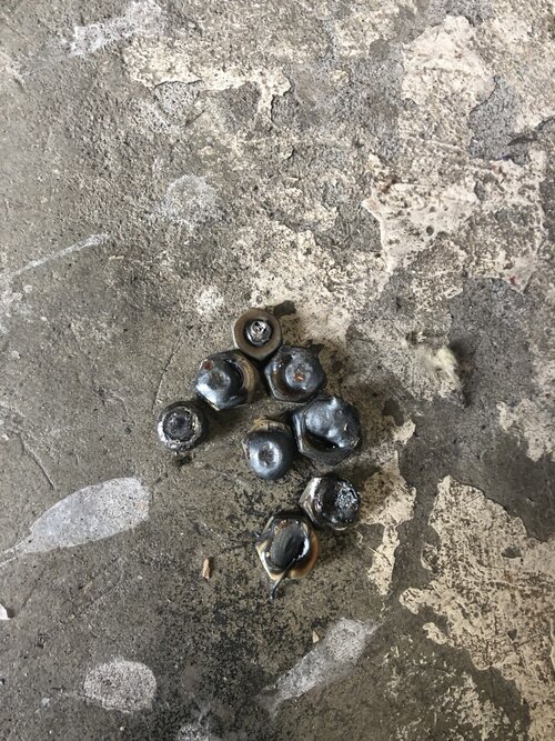

I got a couple that I think melted in the full throat of the nut. No love. Frowny face.

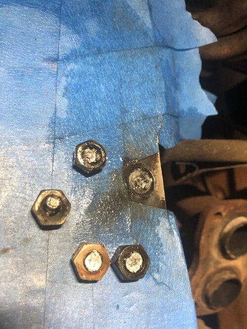

For future reference I started at (I think) 18.0V @ 225 ipm (left most) and the last was 18.8V @ 245 ipm (top one). The bottom two were 18.5V and around 230 or 240 ipm, which filled nice. That last one was too fast, it walked up the nut too fast but seems best on the head bolt side, can see the divot it ate in. The first one was a little too slow and cold to fill.
Wonder if the difference in mass is just too great. The nuts are nearly at melt but it doesn't seem to be really biting the head bolt. Thinking grinding in a cone. Maybe tomorrow, I pretty spent and sore. I'm too old for this shit.
The oil is Kroil I sprayed after. I hit things with brake cleaner to get clean metal before burning. I have plain stuff, 25/75 and 0.030 ER70.

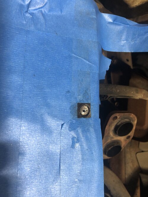

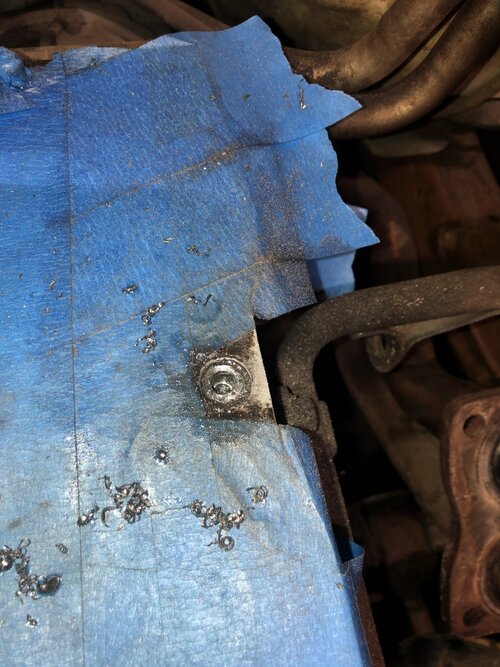

I think I see space at the top thread. So.
For completeness, the top side, same order.

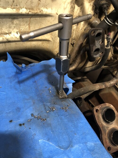

Made the top of the broken section flat and then put a bit of a cone into it with a Dremel. Then very slowly stepped up drill sizes to achieve a nice 1/4" bore that I'm guessing is about 2/3rd into it.
Easy out that fits about 1/2 way in. Just used what I think is mild pressure but it's very reluctant to give up this fight. I'm not seeing any rotation but can feel flex. Some of that is the easy out biting in I suppose, but...

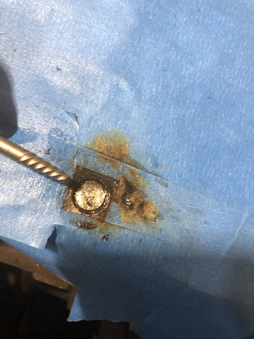

I considered welding again but I'd hate to waste having such a perfect hole. Just look at it. It's magnificent! Never mind it's a little off center. But whatcha gonna do?

That is quite the magnificent hole in a busted bolt. Think how magnificent it will be/look removed from the block!
