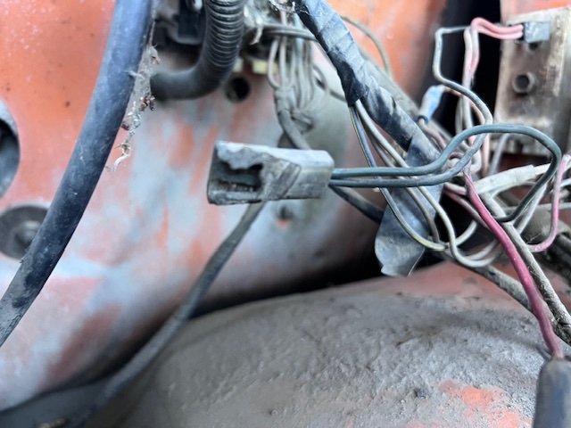

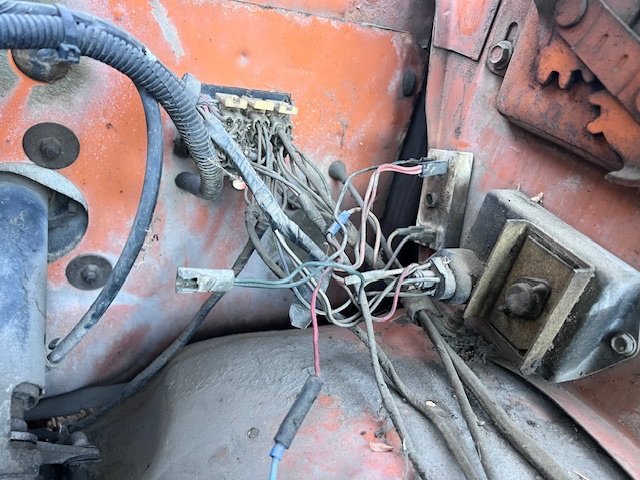

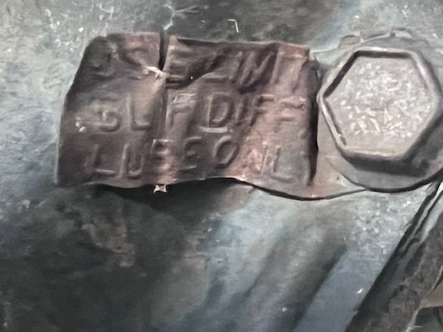

Thanks! Thats super helpful. I’ve got the attached on the rear of the driver’s fender. Not sure what the one unattached wire goes to yet. I don’t see anything that looks like it would be right. But it could be the culprit!
I also found out I think it has a limited slip diff in the rear. Kind of cool.

Not sure if videos will load directly here, but definitely no spark. Erica is usually around to turn the key for me while I do the spark plug on a ground thing. But she’s traveling for work so I went & bought a spark tester. Nothing…
Edit- apparently you can’t load videos directly.
Anyone happen to know what this plug should attach to? Thanks in advance for non Toyota help!

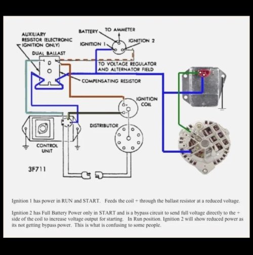

that looks like a “dual ballast” resistor ie 4 posts
can you see where on the control module next to it that green wire terminates to?
it seems similar to the attached, but that top left BR green wire should go to one pin of the control module connector and not splice off like that
but before all that the simple first check is with key on is there some voltage less than 12v at the coil or nah?
When energized, I had just under 12volts at both the positive & negative terminals on the coil. A dodge electronics video said that meant that the control module wasn’t ground out for some reason. Rather than chase farther, I opted to just replace both it & the ballast resistor, plus some other odds & ends I still need to do. But the bottom line is!
