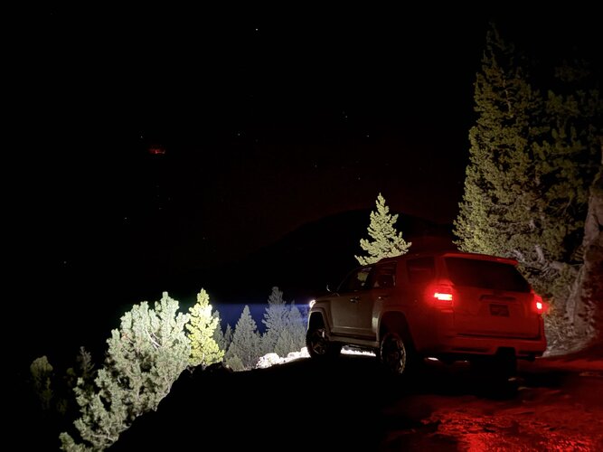

It came with okay enough tires, but the 20" rims didn't exactly let me air down to the extent that I wanted, and a suspiciously timed nail in my tire shortly after I bought it gave me the perfect excuse to upgrade. As such, I got 17" rims taken off of a 2018 ORP, and put on Duratrac RT tires. At the same time, I deleted the XREAS from the system and replaced it with Bilstein 5100's, with a 2.5" lift up front and a 1.5" lift in the rear. Below is the final result, featuring Rollins Pass. Ignore the temp tags, I was still waiting on plates. Additional bonus night picture for ya, too!
