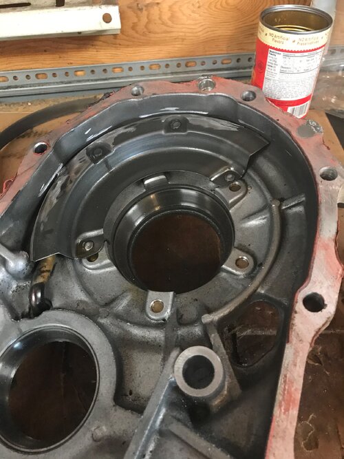

-Both sets of tcase gears are installed with just presswork, no backlash or contact pattern checking. Minor clearance of the oil slinger is necessary but it was easy. I reused my bearings as they were in great shape, sourced some Toyota case seal and installed new ring gear bolts

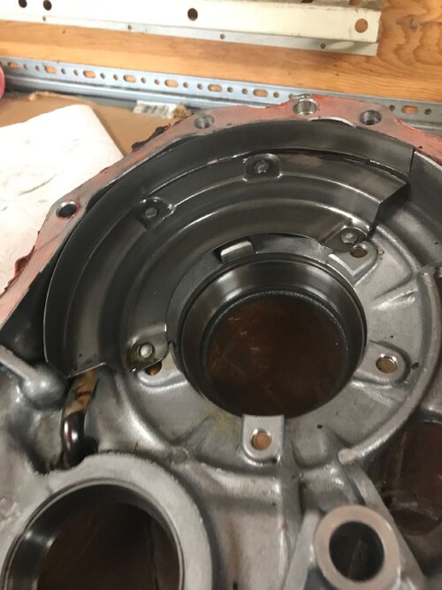

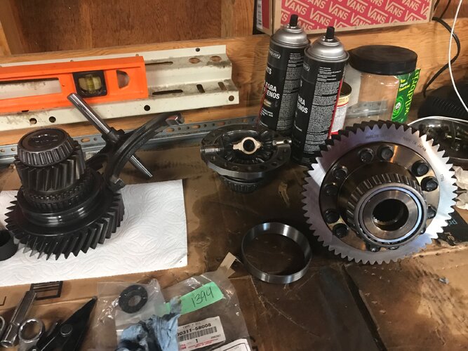

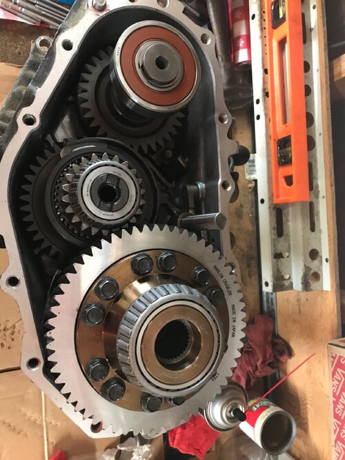

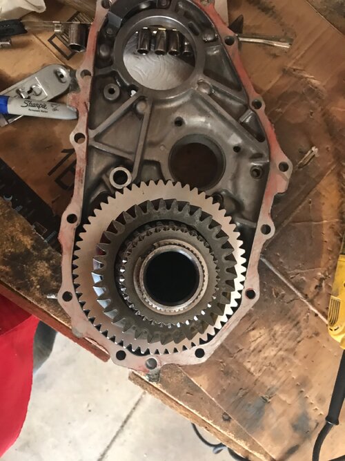

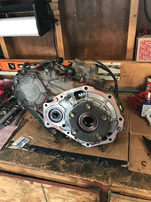

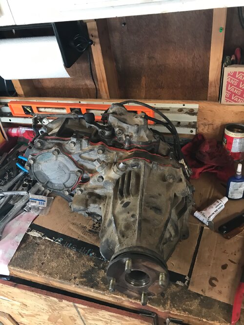

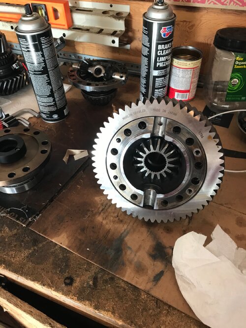

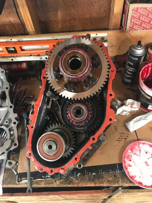

I did the part time kit too when doing mine.
I did need some press work done as mine wasn’t big enough and I didn’t have much in the line of “press tools”.
IMG_9048.jpegIMG_9050.jpegIMG_9052.jpegIMG_9053.jpegIMG_9055.jpegIMG_9056.jpegIMG_9057.jpegIMG_9058.jpegIMG_9059.jpeg
