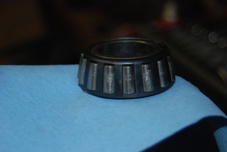

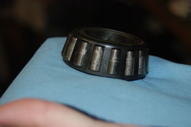

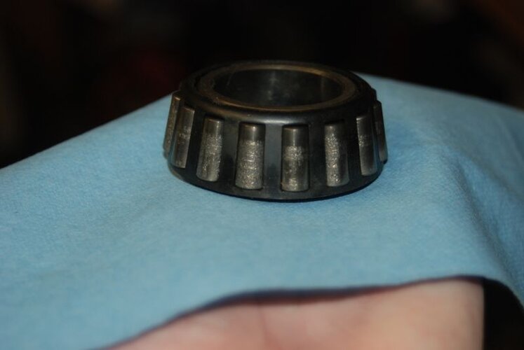

unless your wheel bearings look like this... your fine.

It's funny the pics make it look like a knuckle bearing but that is indeed the smaller of the two wheel bearings. If was off my 64 probably an original koyo. It would have went another 100k. the race was just as bad. I was going to just repack them and run em :hill:

:p: You definitely got your money's worth out of those. Did it spin on the knuckle? Kind of a roller bearing/plain bearing combo?? :lmao:
only 102k. The knuckle had a good mix of gear oil and lube. I wasn't planning to replace the wheel bearings but that one looked a little rough. I'm sure there are plenty of cruisers running across africa or aus with a bearing that looks like that. I don't think it spun on the knuckle. I'm sure I'd remember if it was the case but that was some 2 years ago when I did the work. I had to keep that bearing around though:eek:
