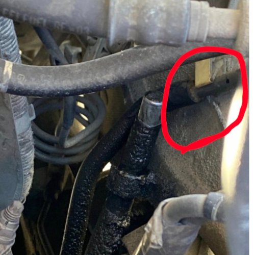

@DaveInDenver , it looks like your other breather is missing the cap. Screenshot_20250428_233941_Samsung Internet.jpg
@WildCrustacean, do you have a second breather there? I don't see it in the pic.
I do not have a second breather like that. I know some people reroute the rear breather with a hose, but mine doesn't have that.
