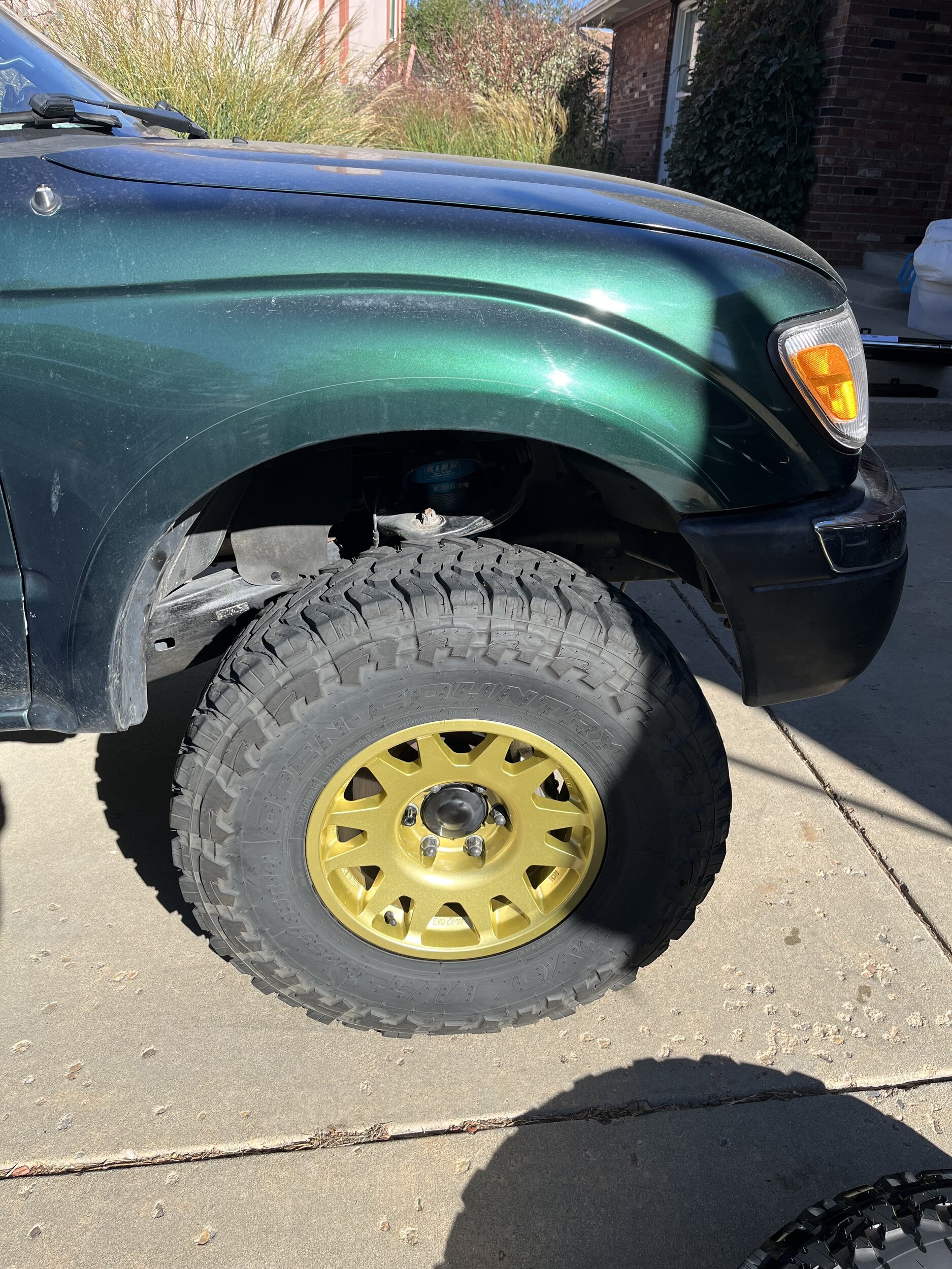

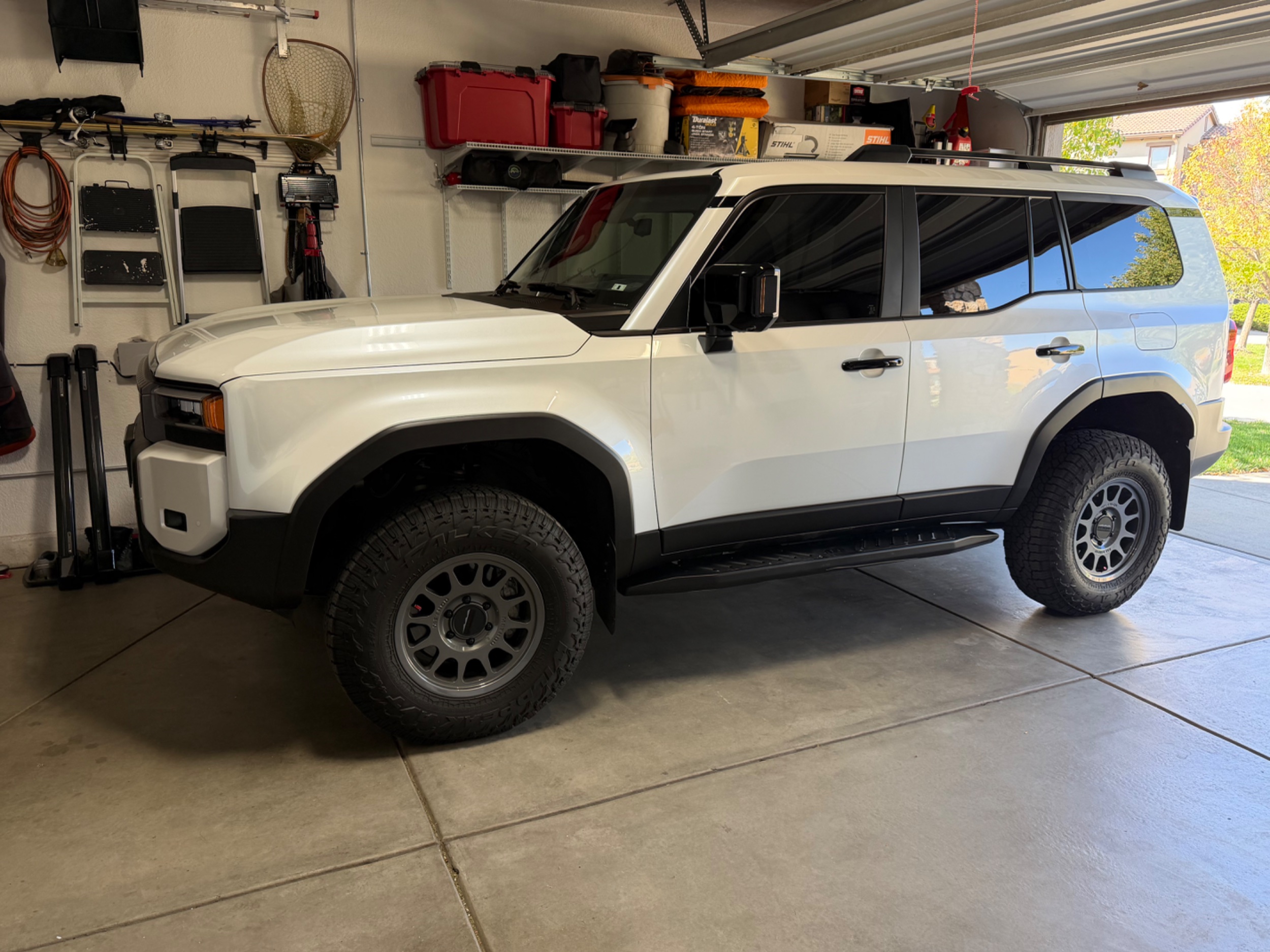

What size tire are you running? I just ordered those same Methods for the LX.
I run 255/80/17 Falken WP AT4s most of the year. I run Nokian Hakkapelita 275/70/18s in the winter and will be moving away from the OEM wheels in the winter to Method 318s due to the 60 offset on the OEMs being too tight for the new BP51s and OME UCAs.

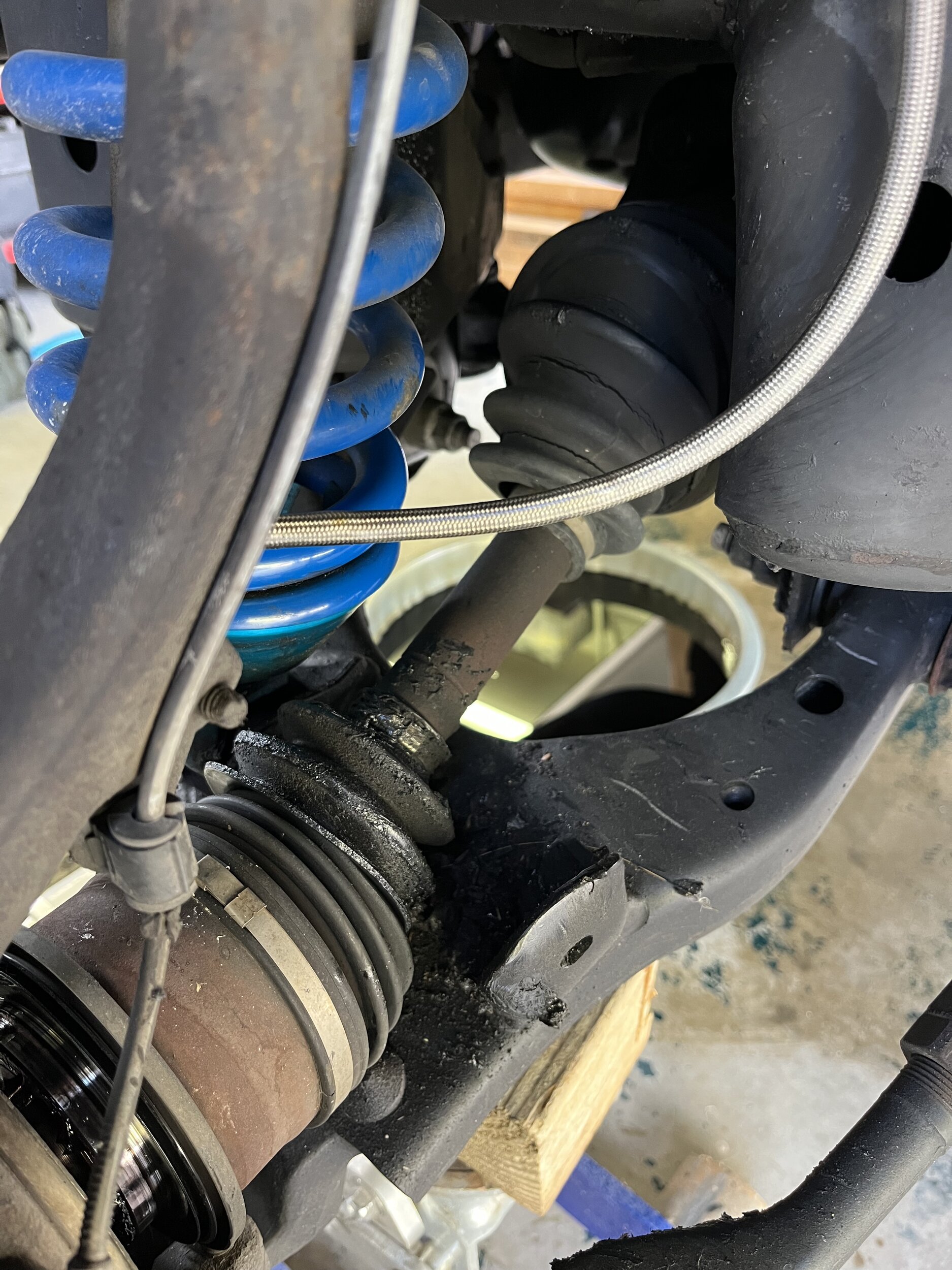

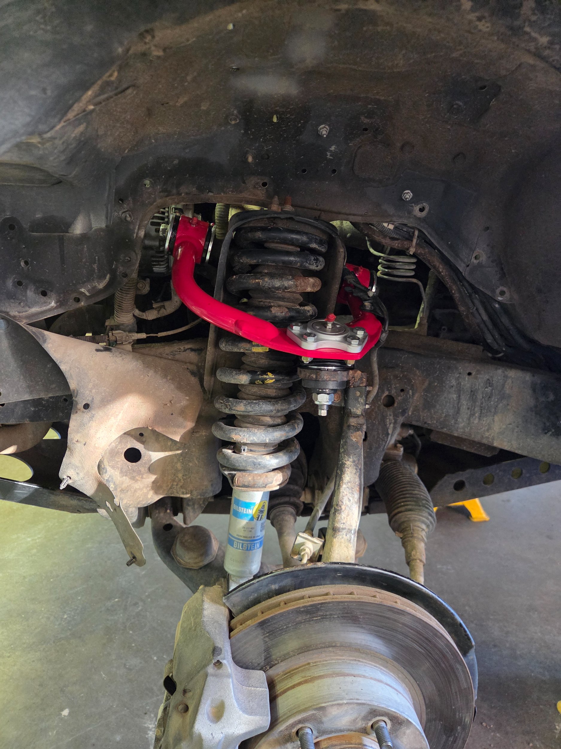

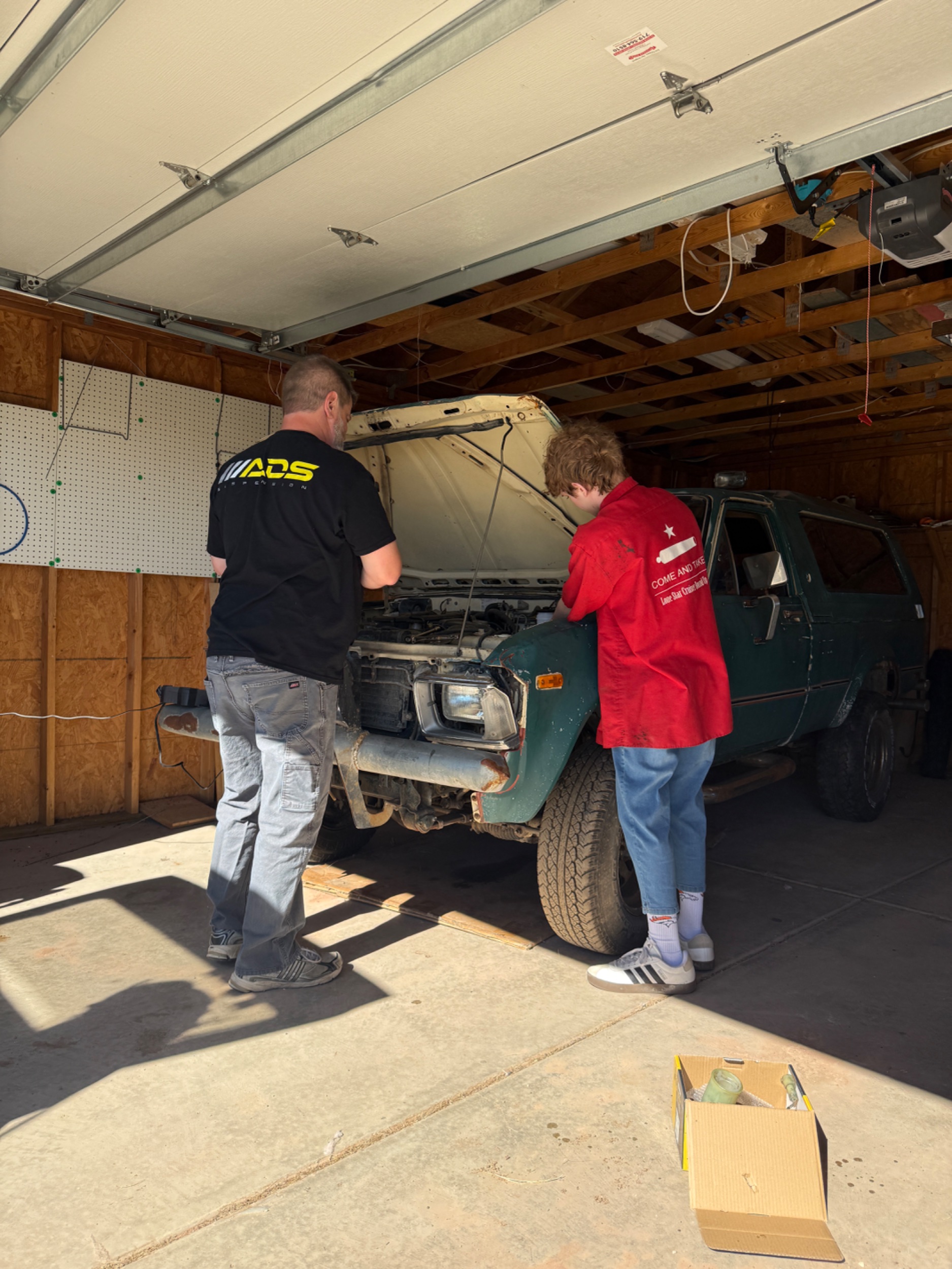

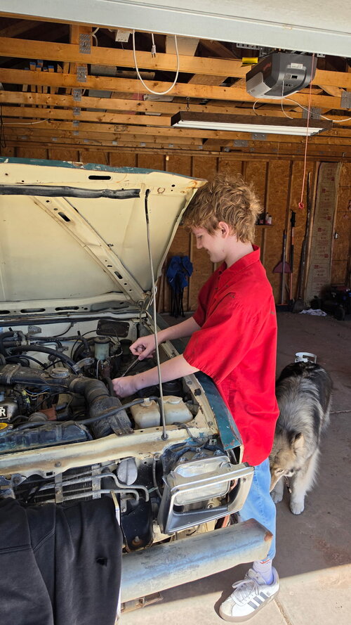

Replaced the long over due CV’s in the Tacoma today. Was no where near as bad as I made it out to be. Also changed the oil and rotated the tires and cleaned the rims 😮‍💨
Ready for another trip to the ranch though 🤘

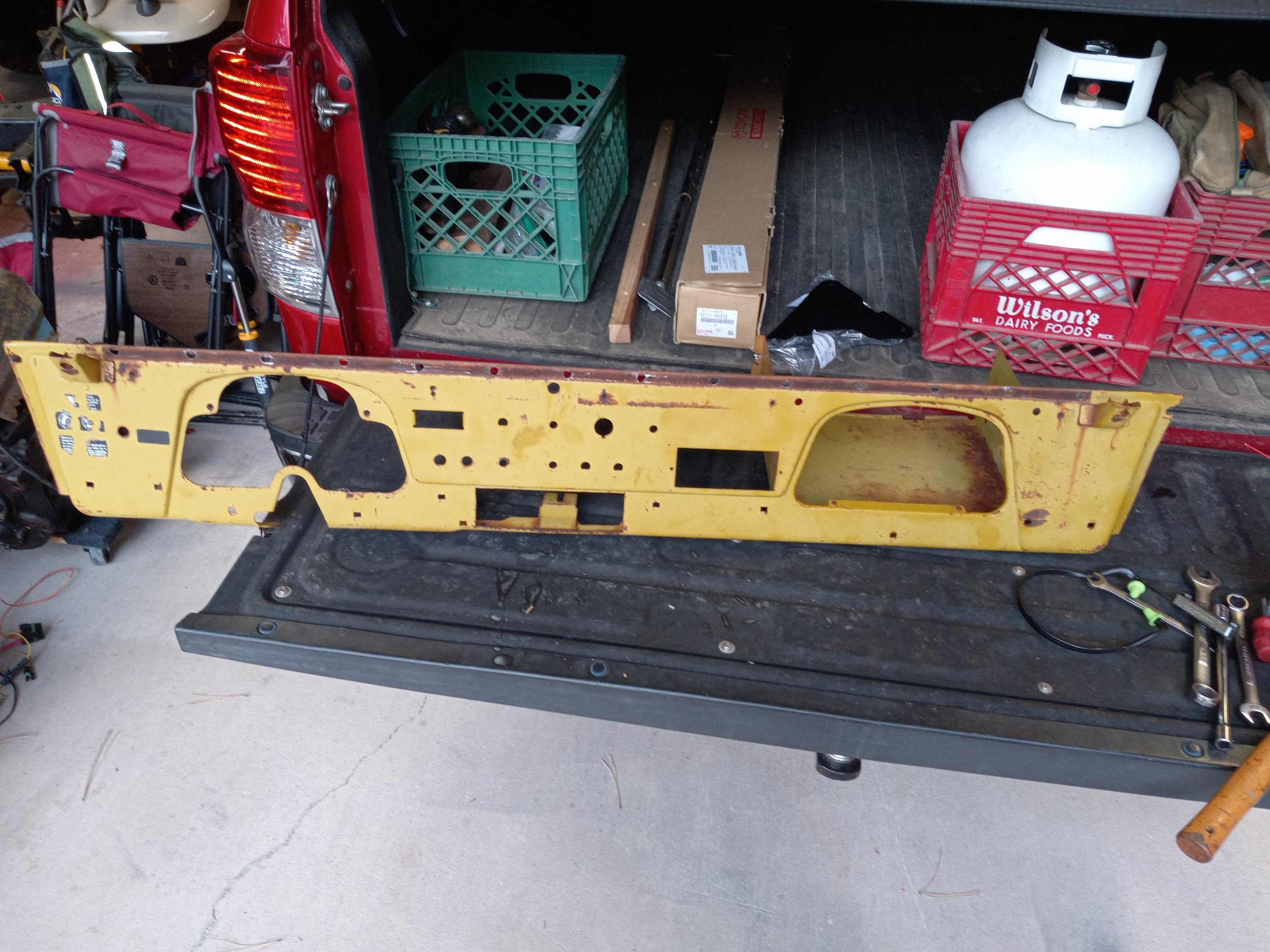

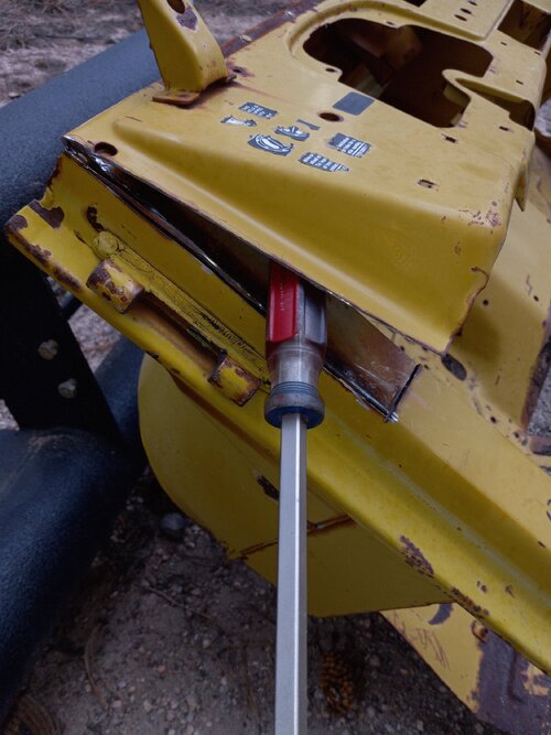

Liberated a dashboard face from an FJ40 carcass. Lots of spot welds to drill out.
