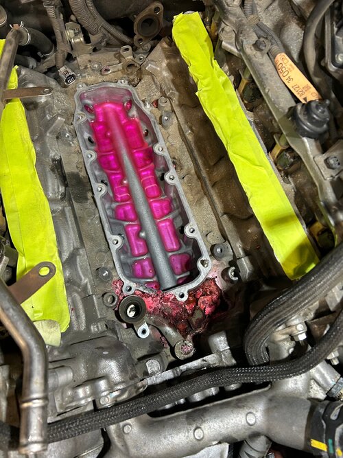

Under the intake at the top of the block there's a little coolant valley that's sealed with FIPG. Either the FIPG fails and/or the machining on the plate is sub-par and so coolant starts to leak out. Usually it just dries up into pink grainy stuff, but if the leak gets bad enough it'll start dripping down the back of the motor.

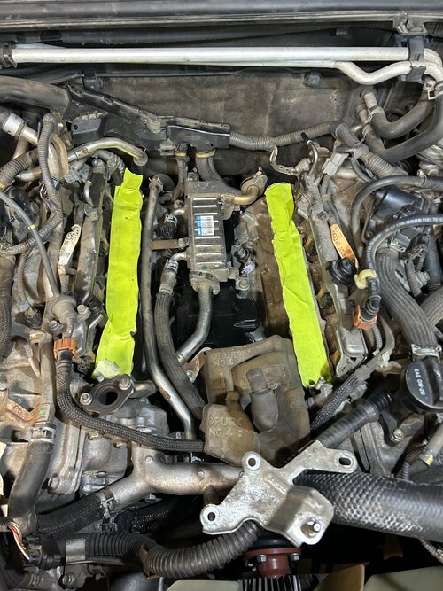

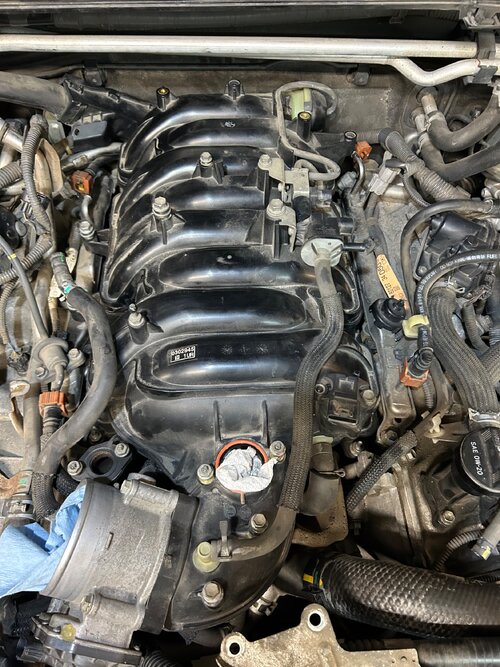

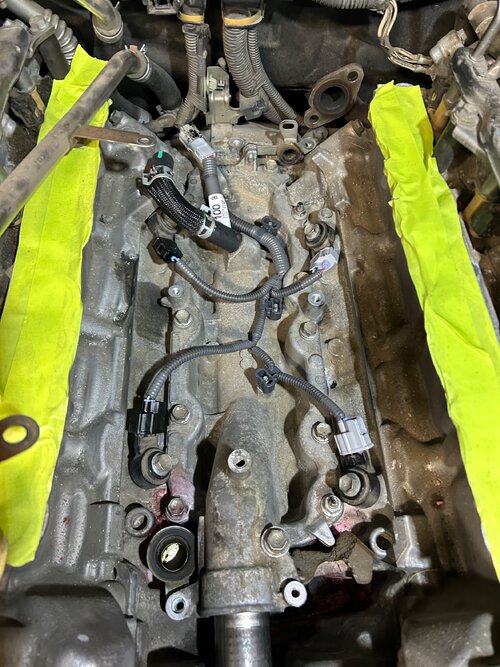

I think I found the problem.... :rolleyes:
5,462
Nice, looks like you caught it earlier than some people. Are you DIYing it?
It’s done. Not puking coolant so the inlet pipe o rings must have set in ok. Replaced some coolant hoses, knock sensor harness and PCV parts “while I was in there.” The worst part was the firewall side manifold bolt. Glad it’s done.
