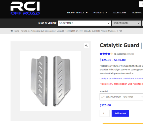

20% off at RCI currently..
Which interior color did you get?
Ecru!!
I've had a lot of black interiors over the years, but have gotten into lighter ones. This is NuLuxe, not leather, and I'm hoping I can keep it clean and it'll wear well.
I'll look into the RCI stuff. It appears those are intended to go with their skid plates, correct?

BTW, this is the cat protection I'm considering:
