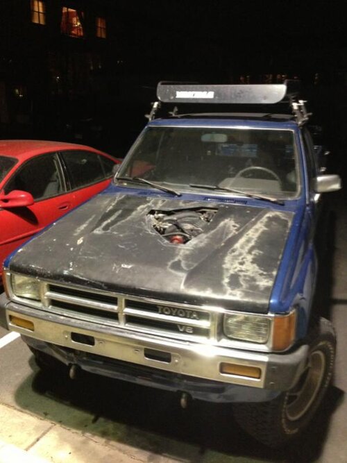

Officially has a hood! Woot!
Take THAT Cobain!
Squishy!
Mar 20, 2007
2,713
Littleton, CO
Ok from the grave...
As most know the Blue Raja has been running quite well for the past 2 year with the 3.4 and SC. Yes it still has a hole in the hood. Here's a couple pics with the rooftop tent rack build and such
