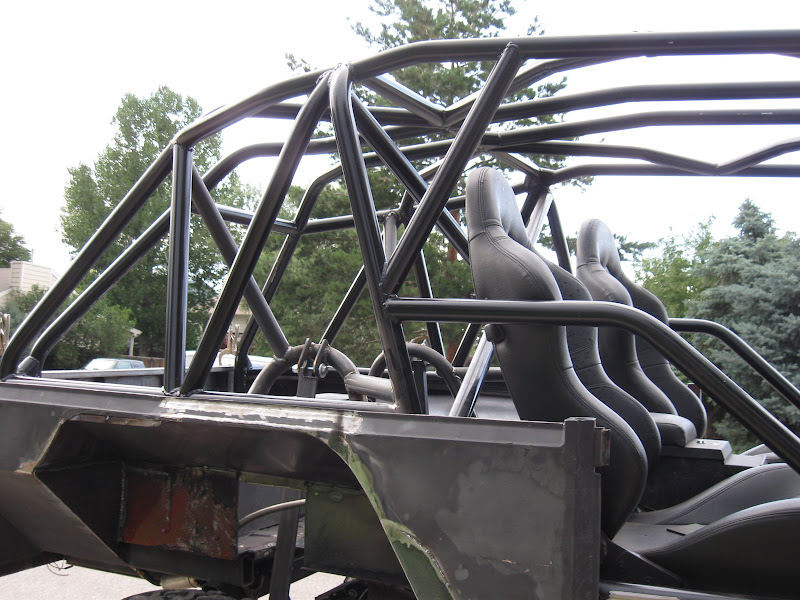

To be exact there are 12 sticks 20' long with quite a few drops and that is the complete total front end, cage, shock hoops etc.
240' of 1.75 x .120HREW I suspect? 1.75x120 HREW is 1.892#/ft 240x1.892=454.01 lbs+welds, plates, bolts, gussets, misc scabs = 500lbs of shark cage! WOW! Thats nearly the weight of all 4 wheels and tires....screw the spare! :eek:

ya pretty much hit the nail on the head there UB, only I didn't use all HREW the main members of the cage, i.e. main hoop, rear hoop, A pillars and rear pillars are DOM. But basically the same weight. The cage its self is only probably a couple hundred pounds me and aaron carried it around the shop with out any trouble. It has a little more tube than the normal cage because the idea was to show what Clover Customs was able to do :)
Thanks for the input. Im thinking about posting up pics of finishing this thing, have all the previous pics, was gonna do a build up thread, but I figured nobody would wanna watch me build my crap.

Looks like it's a coil suspension (maybe even on both ends?), with hydro steering. I don't see any leafs but I do see trailing arms (or panhard bars or whatever you want to call them)...are you going to coilover the rear? It looks like a coil spring bucket on the rear axle, but right now there's that angle iron "shock" going up to the shock hoop... UB don't know what else you're referring to?

Matt - Yes it has 18" travel coilovers on all 4 corners. There is a dual triangulated 4 link front and rear attaching the axles to the frame.

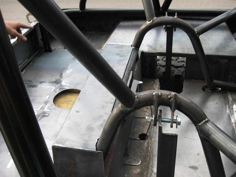

Actually you can see it even better in this pic if you look at the floor ;)
That thing in the back is covering the fuel cell, with storage under it for birfs and axle shafts. Helps keep things together and the dogs off my aluminum fuel cell. You do see a roller fairlead in the back point towards the front that is the rear suck winch

the rear of the frame is cut off?
The back part of the tub is angled in (think that has a name, but not sure what it's called)?
