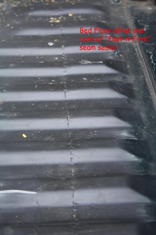

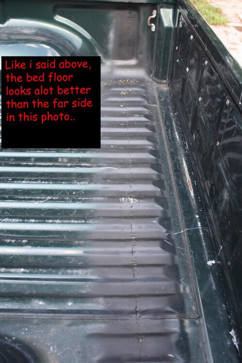

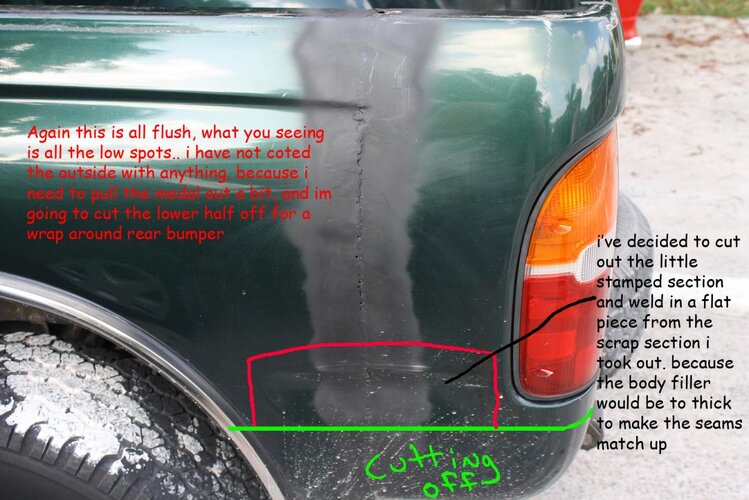

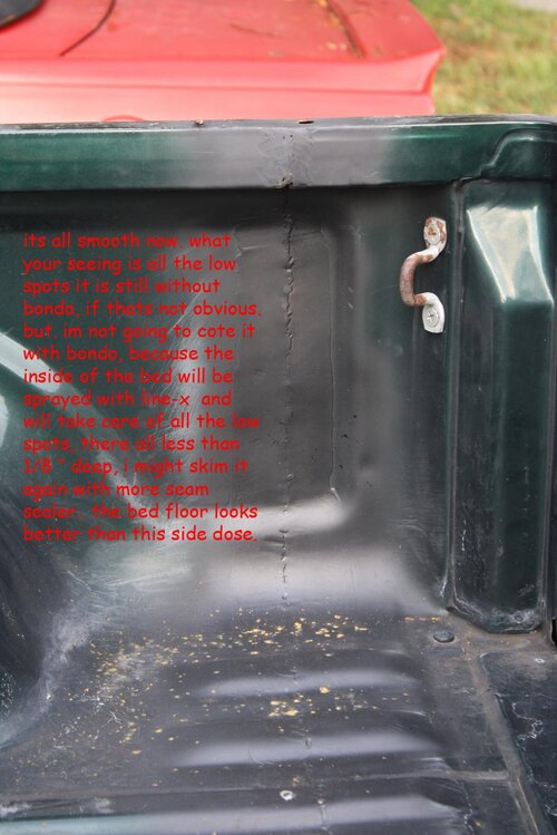

from this point it will be a week or 2 b4 any major changes.. i might do some bondo work, but highlly doubt it because i hate body work.. :beer:
