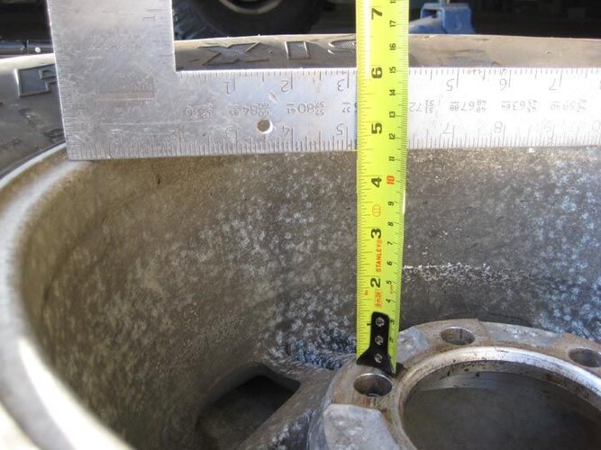

Stock Tacoma wheel backspacing today measured just under 4 3/4". So that's about 1/4" closer to the frame than an 80 rim, at least what the word on the street says 80 backspacing is... I'll try to measure my spare on the 80 later tonight once everyone else is in bed to verify.

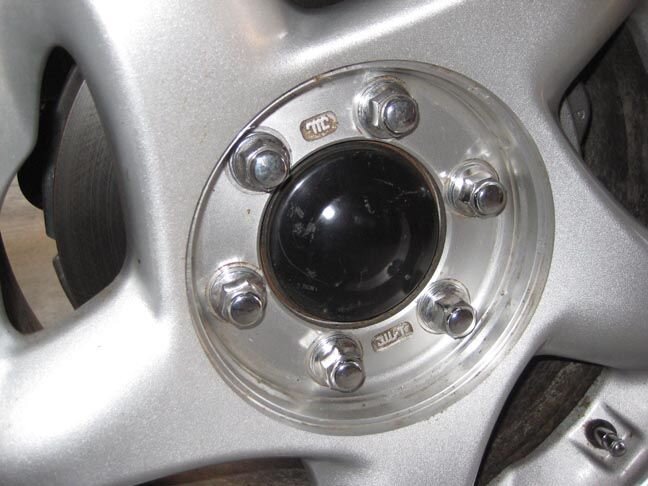

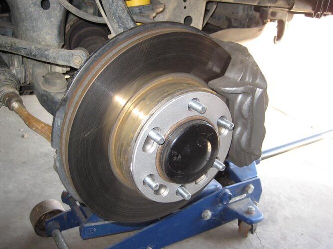

Yesterday I lowered my front end about 1", and made this problem a little worse. :rolleyes:
So today I went ahead and installed the death rings, and it's quite a bit better, however I can still make it hit when I'm cranked to the PS and the PS tire is up on a curb. It's better than it was last week though without the spacers and before the lowering...
15,534
Took it out for a spin tonight and no wobbles, got it up to 75... so calling that good. Next step is raise the front end another inch or so and I should be golden. :hill:
