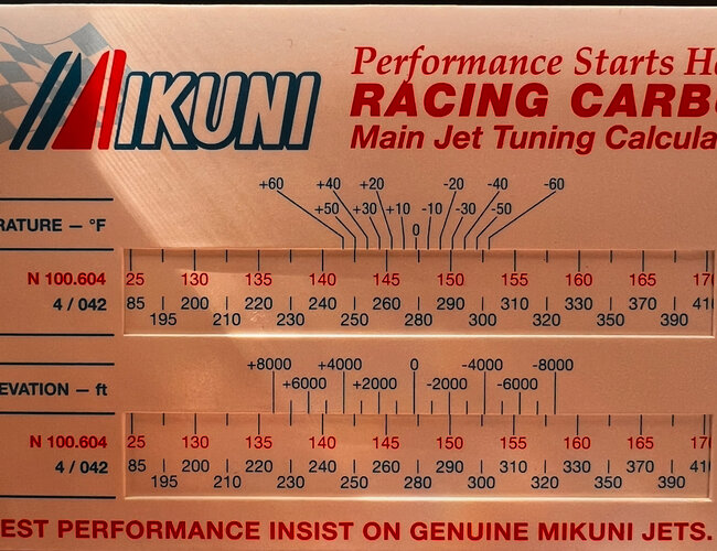

Just to duplicate what I have on ‘mud
For those of us at altitude I forgot I had this little tool from Mikuni. I’m not sure I’m using it exactly right, but it looks to me like I should put a 140 into the carb at my altitude andwork up from there to see if it helps keep the plugs from fouling.
@Cruisertrash pointed out on ‘mud “ I see the point of going up or down in size, although many vehicles have systems built in to compensate for elevation. So if you installed the jet appropriate to your elevation (according to this sheet), then the HAC would make you far too lean. It’s a dance.”
So I’m going to plug the inlets to the carb from the HAC but keep the 6 deg advance when I start messing with the jets. I mean you can go down the rabbit hole of temperature and altitude too!
Thanks again - hope to meet some of you in the future
